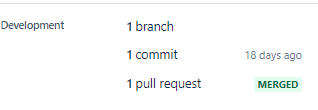

Wanting to create automation to move a card to a status once a Pull Request has been merged. We are using GitHub for our PRs and they are being displayed in Jira as the Development field. Has anyone any knowledge on how to make this work?

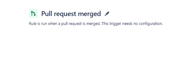

Thank you for this Bill. How do I connect to Git? The pull request merged rule trigger states that it needs no configuration. Thanks

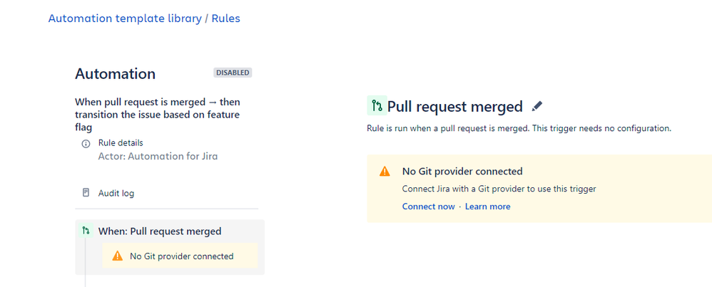

We have developmental tools connected to Jira using Git. What I am not seeing is how to connect my merged pull request in the automation. It is not showing like your example.
2021-12-30 10_06_52-Automation - SSB Jira.png2022-01-01 12_40_28 - Jira.png2022-01-01 12_45_21-Automation Playground _ Atlassian.png
Bill Sheboy
January 3, 2022
Using the left-side panel, please check project settings > developer tools to learn if you have the tools connected to your Jira project.  Once that is done the rule should work as shown in the documentation.  Thanks!
JD Lobue
January 3, 2022
yes, we have developer tools turned on for the following:
Smart Commit producer
View branches
Create and view pull requests
View commits
View builds
View deployments
Yet, I do not have the ability to configure Git in the automation
Bill Sheboy
January 3, 2022
If everything is connected up then something else is wrong.  I recommend creating a ticket with Atlassian support as they may see something in their logs that we are missing.  You should be able to do that here as you are site admin for a paid license: https://support.atlassian.com/contact/#/
