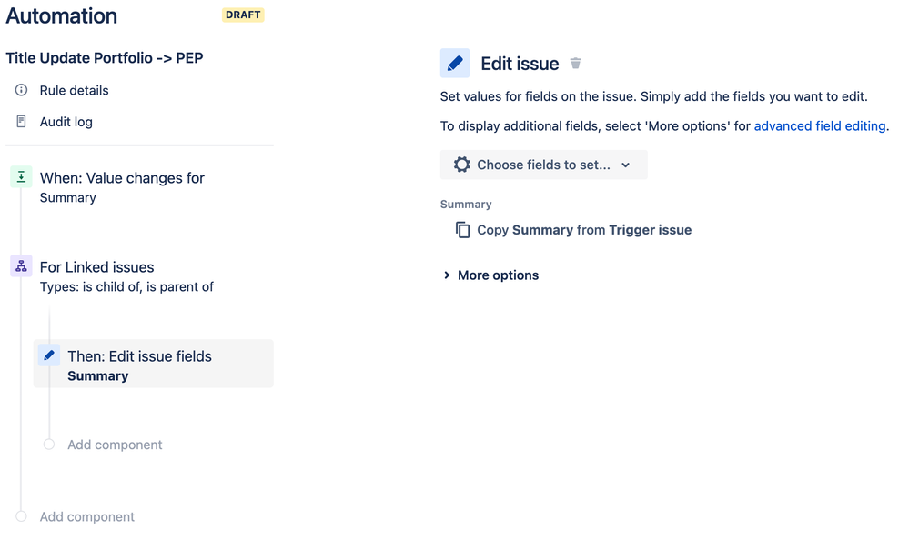

I am using an automation to sync the issue summary (title) between 2 projects. I'm using the built-in automation called: Copy Summary from trigger issue
I would like however to create a custom name composed of the issue key and the summary
Key: "PS-417"
Summary: "Bla Bla Bla"
New Summary: "PS-417 Bla Bla Bla"
Why? Because we report this info to the customer portal into a Jira service desk project and since we cannot choose the field in the portal, I want the customer to know our "internal" ticket as well as it's external ticket. So we figure out to add it in the title.
I am a wannabe Jira expect but very dumb when it comes to json. I have yet been able to build one that works. Can you help me setting up the code that it needs?
Thank you!

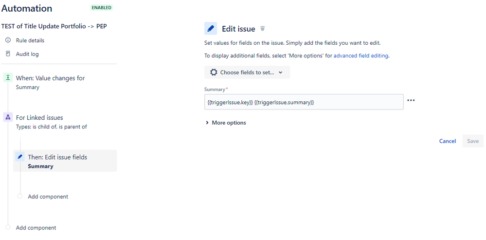

Hi @Bill Sheboy , thank you for your answer.
Yes I say json because I think that's what you need to build with the custom automation code under More options.
Here is the screenshot of the automation that works for now.
Martin
May 5, 2022
@Bill Sheboy  thank you for your help, you made it work!
Can you tell me where I can find these references? thank you.
