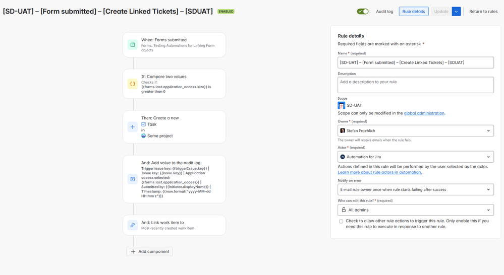

Stefan Froehlich
May 15, 2025
Hi Bill,
thank you for your response.

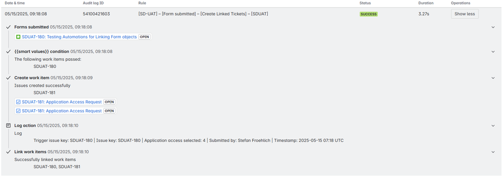

Let me start by saying, I ran the automation today again to create a new audit log for this purpose and for whatever reason it just worked now...
However, I am still posting the automation and the audit log from today as well as yesterday's here:
The only odd thing about the audit log is why it would show the created work item twice.

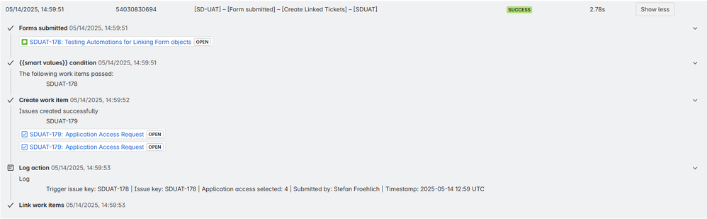

The only difference here is that yesterday's audit log shows a checkmark at Link work items but then doesn't show the actual tickets linked
Bill Sheboy
May 15, 2025
Thanks for the additional information, and...it is quite curious where without changes it worked this time.
Perhaps this is a timing problem caused by a delay after the create or from the forms submitted trigger.  To help mitigate that cause, after the Create Work Item action please add a Re-fetch Work Item Data action.  That will slow the rule slightly to reload the data before it proceeds.
