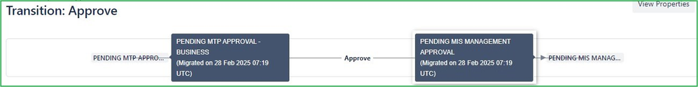

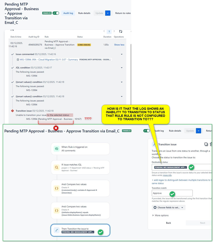

Testing a migrated "Premises" JIRA instance to JIRA Cloud. I am using "Automation For JIRA" to transition a workflow from the Status its in (Pending MTP Approval Business)  to the rules Destination set Status (Pending MIS Management Approval). The rule runs and passes all of the rules logic until it hits the last part to "Transition Issue". When I inspect the failed portion of the rule it says "Unable to transition your issue to the selected status:
Pending MTP Approval Business, which is the status it is in. The rule validates fine but fails and shows that its failing something that's not even set up in the rule to begin with. Please help. I have already tested permissions/actors etc. Is there a know bug regarding transitions at this time?image.pngimage.png

Hello @Greg Abbenante
Do you have more than one transition path between the starting and destination statuses? If not then clear the information in the Transition match field in the Transition Issue action. Use of that field is only needed when there is more than one transition path available between the statuses.

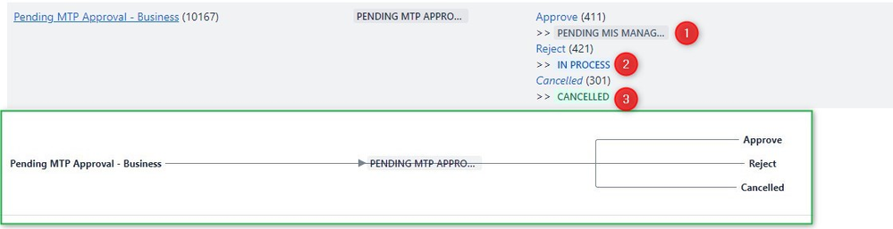

I have 3 possible Statuses - the one I am attempting plus "In Process" (when Rejected) and "Cancelled" (When Cancelled). Only Approve and Reject utilize Automation for JIRA.image.png

I did try with and without the "Approve" Transition match - fails both ways. Also these rules execute as expected in our Premises Server - its our new Cloud version (migrated) that is failing

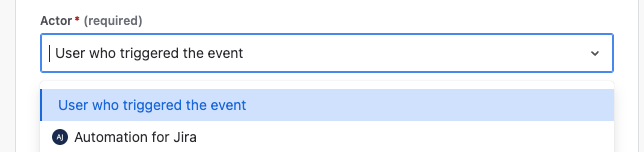

If the transition has a Condition that the user must match the contents of the field Business Approver, then the Actor of the rule must be a user that matches the contents of the field Business Approver for the issue that triggered the rule.
Testing the permissions of the Actor to transition issues (in the Projects Permission test area) does not take into account any Conditions on the workflow transition that impact who can execute the transition.
Your rule is triggered by comments, and checks that the rule Initiator is equal to the Business Approver field. I believe the rule will work if you change the Actor of the rule to User who triggered the event.

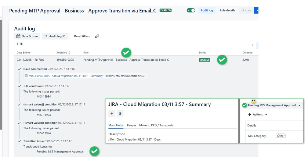

Trudy - YOU ROCK!!! That worked =)   Thank you so much for such quick and potent responses. I will now continue with a full end to end test for my workflows, much appreciated ;)image.png
