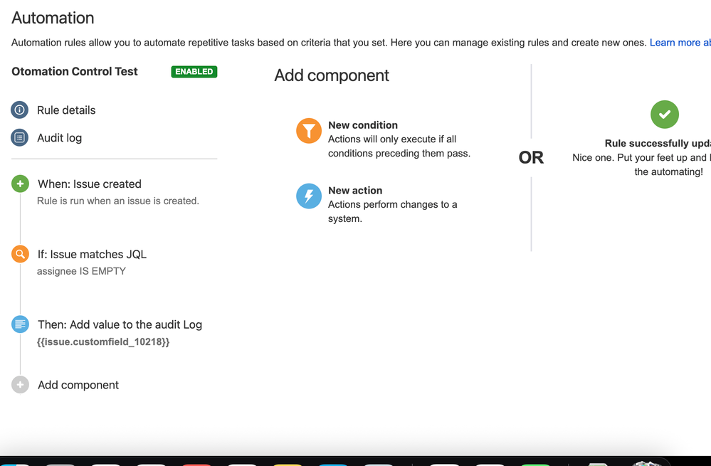

Hi Experts,
I am trying to configure an automation in a Data Center environment. However, even though it is within the project scope and I have kept the conditions quite simple, the automation is not being triggered. Additionally, there are no entries appearing in the audit log.
I have tried using different triggers such as create, transition, update, and value changed, but none of them are firing.
What could be the reason for this issue? Do you have any suggestions?

Ömer Gündüz
March 19, 2026
Hello @Arkadiusz Wroblewski
The rule is active, and when I validate the JQL condition using the “Validate Query” option, it returns issues. However, despite this, the rule does not run and does not trigger under any circumstances.
Even when I remove all conditions and leave only a simple log action, it still does not trigger. At this point, I’m unable to determine how to resolve the issue.

Ömer Gündüz
March 19, 2026
When I did it manually, it recognized the trigger and returned a success. But I don’t understand why it can’t enter it automatically. @Enric Font

Ömer Gündüz
March 19, 2026
I think I’ve found the issue. The automation wasn’t running at the create stage because the workflow didn’t have a created listener. When I updated the listener to a created listener for testing, the rule worked. So, where are these events defined, and how can I view their purpose in the system?
