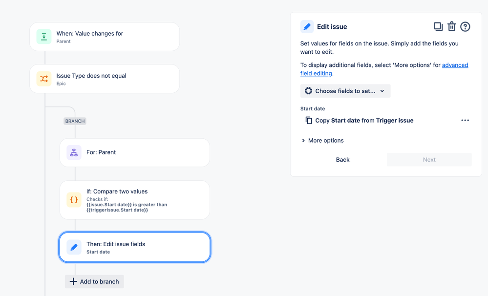

I did this by comparing the start date of the trigger issue and the Epic. If the trigger issue's start date is less than the Epic's start date or the Epic's start date field is empty, it will copy the trigger issue value to the Epic.
However, I think the lookup issue action will be more precise. If I use the current method, even the system copies the value from the child issue, but we cannot guarantee that the date is the earliest date from the child issue.
I tried to use Smart Value Comparision to compare the original Epic ({{#changelog. epic link}}{{from}}{{/}}) and the new Epic ({{#changelog. epic link}}{{to}}{{/}}), and lookup the value from the new Epic if a child issue added in it. However, it doesn't work, and it seems the lookup action didn't support the Start date field. So I'm still figuring out how to read the child issues' Start Date when an issue is removed from an Epic.

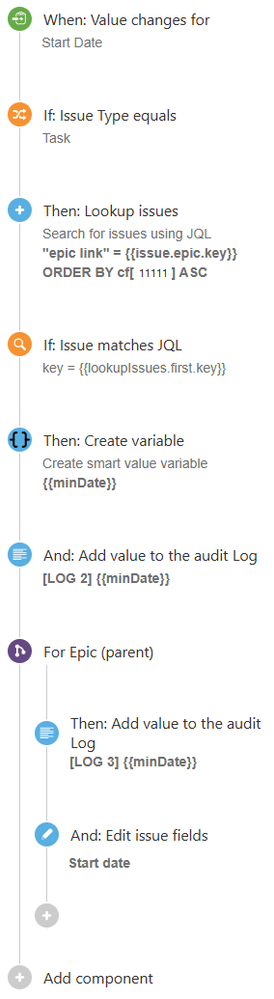

I ran into the exact same issue trying to update an Epic’s Start Date and End Date based on its child issues using lookupIssues. After lots of frustration with Branch: For JQL not executing (even when the issue key was correct), I finally found a workaround that works reliably within native Jira Automation—no apps, no webhooks.
What didn't work for me:
Using Branch: For JQL with key = {{lookupIssues.first.key}} → the branch wouldn't run, no matter what I tried
Creating a variable (smartFirstKey) and using it inside the JQL → same issue
Logging showed values were correct, but the branch simply skipped
What worked for me:
Use lookupIssues to get child issues of the Epic, sorted by date:
You should use customfield value, not like "Start date" or "End date".
"Epic Link" = {{issue.epic.key}} ORDER BY cf[11111] ASC
Use If: JQL condition instead of a branch:
Inside that condition, create a variable:
Variable name : minDate
Smart value : {{issue.customfield_11111}}
Then, in a separate Epic branch, use that variable:
{ "fields": { "Start date": "{{minDate}}" } }
    or just do match them on UI console directly.
Do the same for End Date using lookupIssues.last.customfield_22222.
In End date case, change Start date(for example, customfield_11111) ASC to End date(for example, customfield_22222) DESC
Why this works:
If: JQL actually resolves smart values more reliably than Branch: For JQL
Creating the variable inside the conditional block ensures the value is set before you reference it
The Epic branch works because it’s related to the triggering issue and doesn’t depend on JQL parsing
Hope this helps someone else avoid the 6-hour debugging rabbit hole I just crawled out of!
