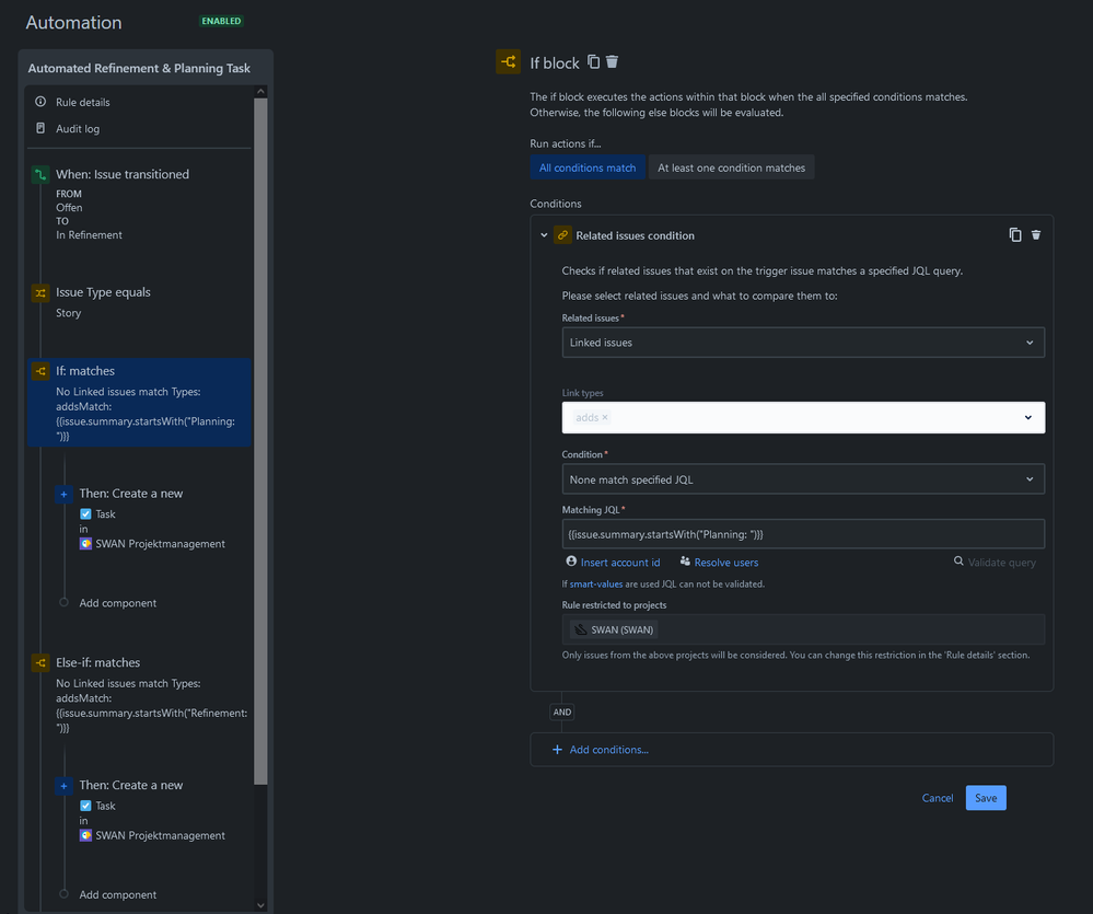

I have the following idea but can't get it to work:
  • When a "Story"s status is changed to "Refinement", I want to create 2 linked issues in another project, starting with "Refinement: " and "Planning: ". <-- This works so far.
  • Now I wanted to change the automation so, that these linked issues are only created if they do not already exist.
    --> I tried doing this like you can see in the screenshot: Check, if there is any linked issue starting with "Planning:"
The last point doesn't work. The automation always creates a linked issue regardless of whether one already exists.
Have I done anything wrong or is it simple not possible to do a check like this?
Thanks in advance!

Hi @Sautter, Tim ,
I see two possible issues:
  1. I'm fairly certain that the related issues condition does not work with smart values. See here for details. But the second one is more important ->
  2. Make sure that your rules applies to all projects involved in this automation. By default rules only apply to their current project. This means that the rule would never find linked issues in another project.

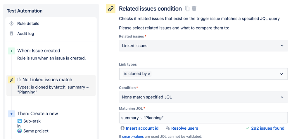

I got this automation to work using the following Branch rule (obviously you can fine tune the conditions according to your own needs):
Again, make sure that your rule applies to both projects (see "Scope" in the image above). Otherwise the rule only checks for linked issues inside the current project.
Hope this helps!
Sautter, Tim
August 16, 2023
What I don't understand is: why does this work then? I mean, the new task is also in another project, not covered by the Scope, but I can change fields there?
Ah, and I cant change the Scope :-/
Els Bassant
January 10, 2024
Apologies, I missed your answer. It is probably way too late, but I'll answer anyway for anyone who finds this thread later:
  1. Creating an issue in another project works because the scope of the automation applies to the trigger and conditions. The actions are separate from this.
  2. The scope of an automation can be adjusted on the details page. So you initially create your automation like normal, then go back to the details page to adjust it. You may need Jira Administrator permissions to be able to adjust the scope to multi project or global.
Tomáš Vlach
August 15, 2023
Hello @Sautter, Tim
I would say its because its restricted to the SWAN project only the linked issues are from different project, they wont pop up in the JQL Search. You need it to set the rule for both projects in my opinion.

HI @Sautter, Tim Welcome to the Atlassian Community!
Have you considered using "Contains" instead of starts with? I have used a similar query before and accomplished the same using "~".
Here is an example of how I have implemented it:
Sautter, Tim
August 15, 2023
Yes, I've tried that, too. I'm afraid it didn't work.

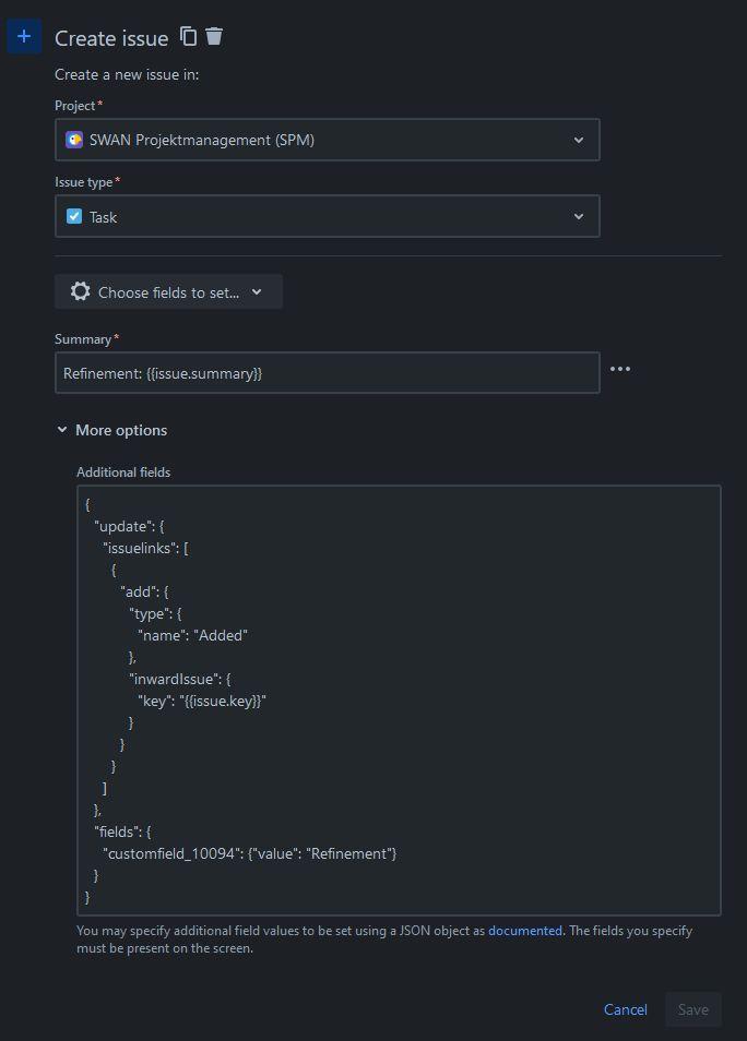

David Blank
August 15, 2023
@Sautter, Tim can we see a screenshot of where you are setting your link type in the create issue action? Could it be that you are reversing the link description? Adds vs. Added by? (not sure if added by is the reverse of adds, just guessing).
I am wondering specifically if you could be referencing the wrong link description (outward vs. inward)

Sautter, Tim
August 15, 2023
The problem doesn't lay there. Here are 2 screenshots: before and after the status of the main issue changed:
[redacted]
--> There are now 2nd Planning task.
What I want to achieve is, that there are no duplicate tasks. Therefore I tried it by using an if condition checking for the newly created tasks name.
