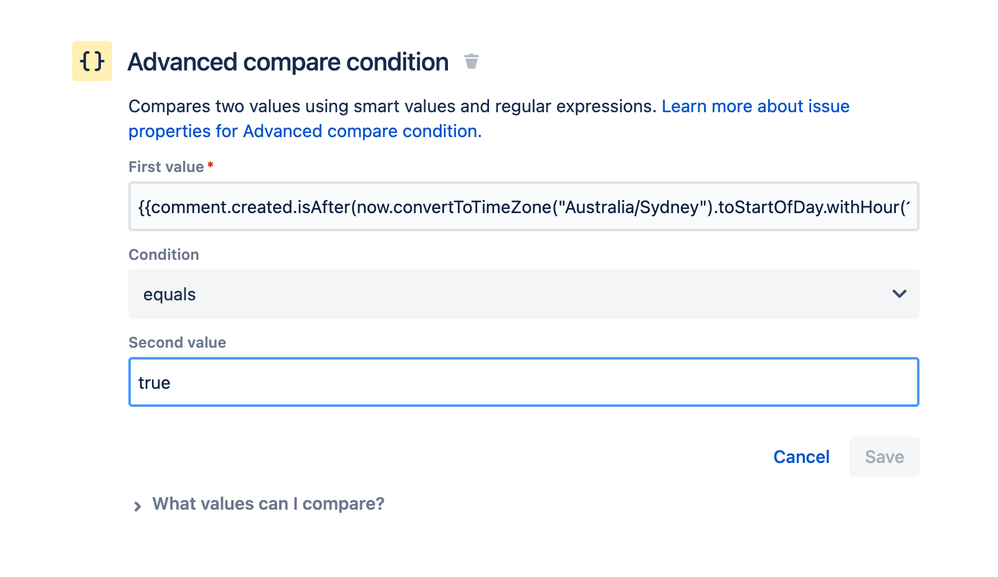

Sorry, I missed your previous messages and apologies for not noticing in your original example.  The problem (which looks like you've already realised) is that you need to construct a valid date object for the comparison.
{{now}} is the best way to get a starting date to convert into whatever construct you need.
{{comment.created.isAfter(now.convertToTimeZone("Australia/Sydney").toStartOfDay.withHour(18))}}
I'm also converting to my own timezone so I don't have to figure out what 6pm is in UTC time.

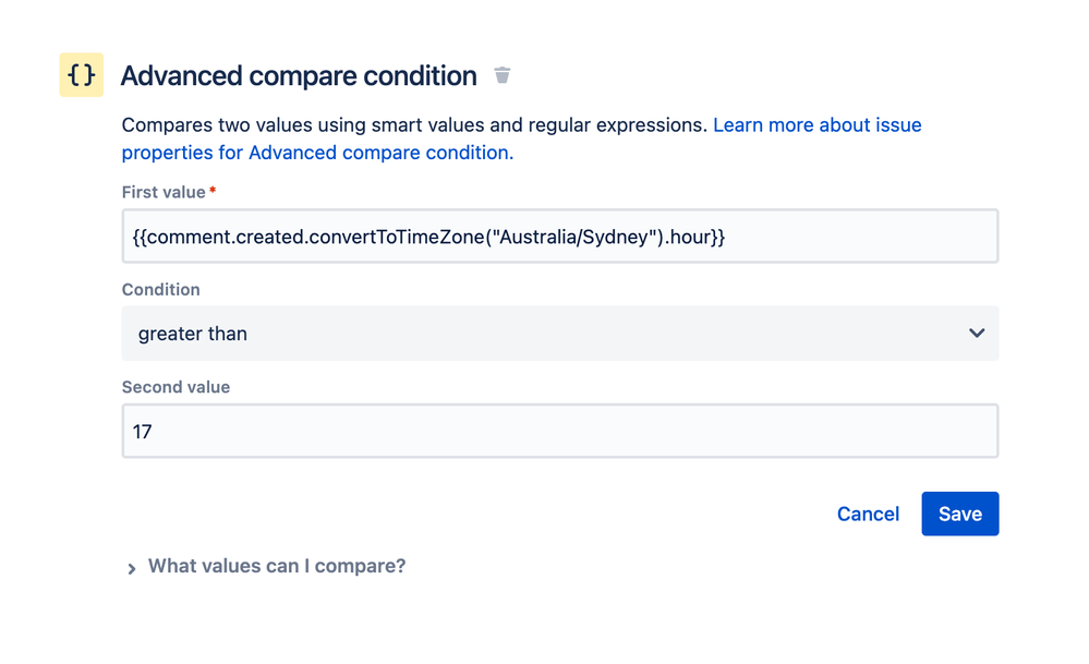

There is an alternative way of doing this which may or may not be nicer for your use case.  You can actually inspect the pieces of the created date instead.  e.g.
Screen Shot 2022-10-19 at 10.07.43 am.pngHope that helps,

Also, as Trudy mentioned, the JQL condition is not the right condition type to be used for this type of query.
Instead, the Advanced compare condition is the one that's designed for these more complex smart value checks.

Thanks for sending that over @bmccoy !
I have updated my automation to reflect how you have done it in yours, swapping out the timezone for Europe/London.
I will let you know how it goes when I make a test comment later past 6pm.
Ben Greene
October 20, 2022
@bmccoy that worked like a charm, thank you very much!

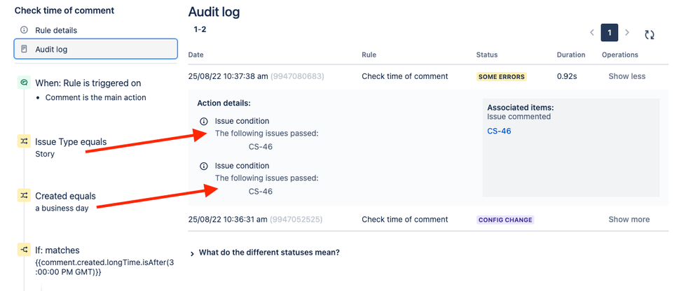

In the Audit Log you should get an "Issue Conditions" message for each condition that the issue passes.
If the entirety of the Audit Log is
'Action details:
Issue condition
The following issues passed: ticket id'
...then only the first condition (Reporter is not one of) is being met by the triggering issue. The second condition (Created equals a business day) is not being met, so none of the rest of the Rule is being evaluated/executed.
I recreated your rule components, and you can see here that I get two Issue Conditions statements in my log.
So, I know it is getting past those two conditions, but the Status of the rule execution is still "Some Errors". That tells me there is something wrong with the IF component that needs to be investigated.
The Log Action is very helpful to add to your rule to log messages and values into the Audit Log to help you debug the rule. For instance, you may want to add a Log Action immediately after the trigger to log the value of Created so you can see what the rule is comparing to "a business day". And I would recommend you use a Log Action to record the value of {{comment.created.logTime}} so that you can see the value being used in the comparison.
Here I've added that last Log Action I suggested.
