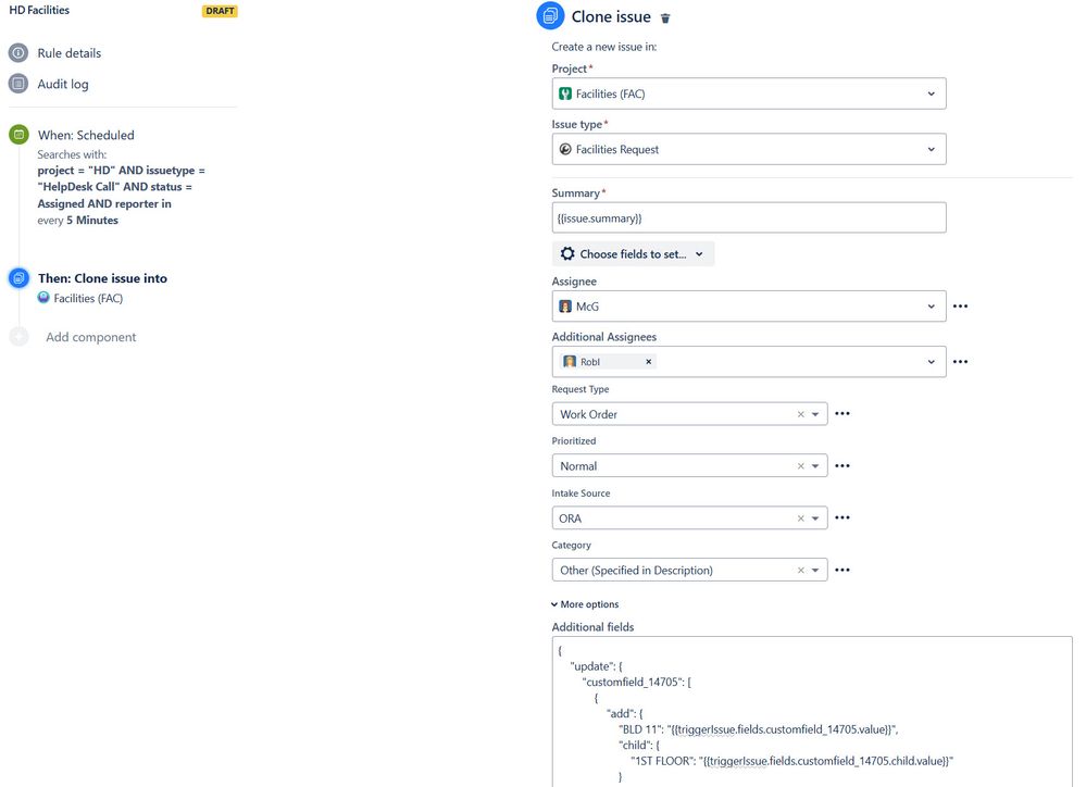

I am trying to use Automation to clone a ticket on a Schedule and JQL query.
Project - HD (this is the source project and the Issue type does not have the Cascading Custom Field)
Project - FAC (this is the destination project and has the Cascading Field, it is also Required to create)
I have tried several versions of the More Options (Additional Fields) as the Cascading Field is not a selection.

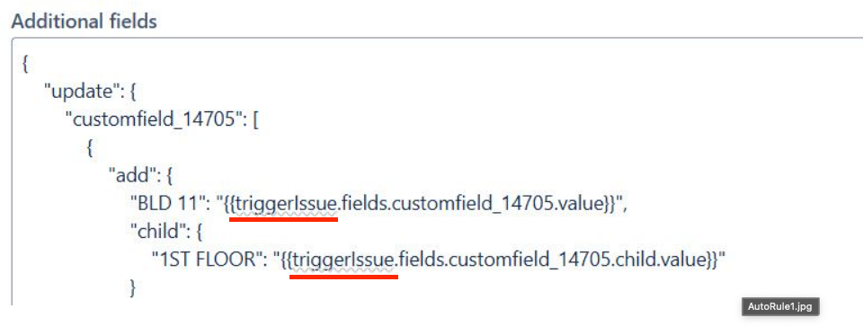

Here is the Code that I am using:
"update": {
"customfield_14705": [
"set": {
"BLD 11": "{{triggerIssue.fields.customfield_14705.value}}",
"child": {
"1ST FLOOR": "{{triggerIssue.fields.customfield_14705.child.value}}"

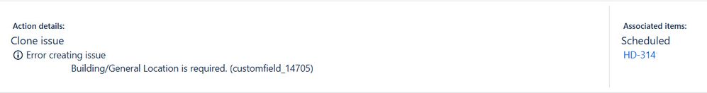

When I run the Automation, it fails stating that it needs the Custom Field.

You said the source project does not have the custom field.
But in the JSON code you are trying to set the custom field in the destination project by referencing values in the source issue for that same field, which you have said doesn't exist in the source project.
When you use triggerIssue you are telling the automation rule to get a value from the rule that triggered the issue. If customfield_14705 has no value in the trigger issue, then the above code is supply no value to use in setting the field in the destination issue. Therefore the field is blank and the validation to ensure it has been filled in fails.

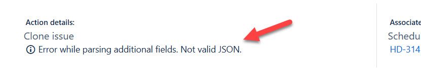

And it's giving me - Error while parsing additional fields. Not valid JSON

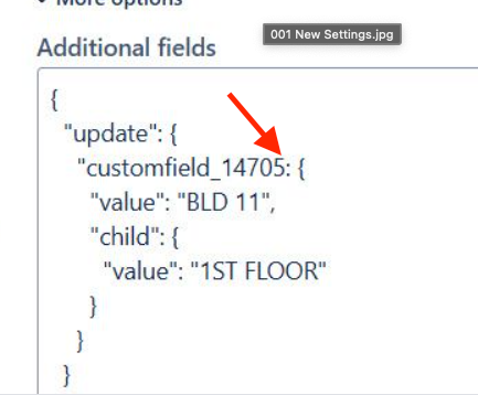

Can you provide a screen image showing the code you pasted into the action?
AndreH
June 24, 2025
Here's the screen shots

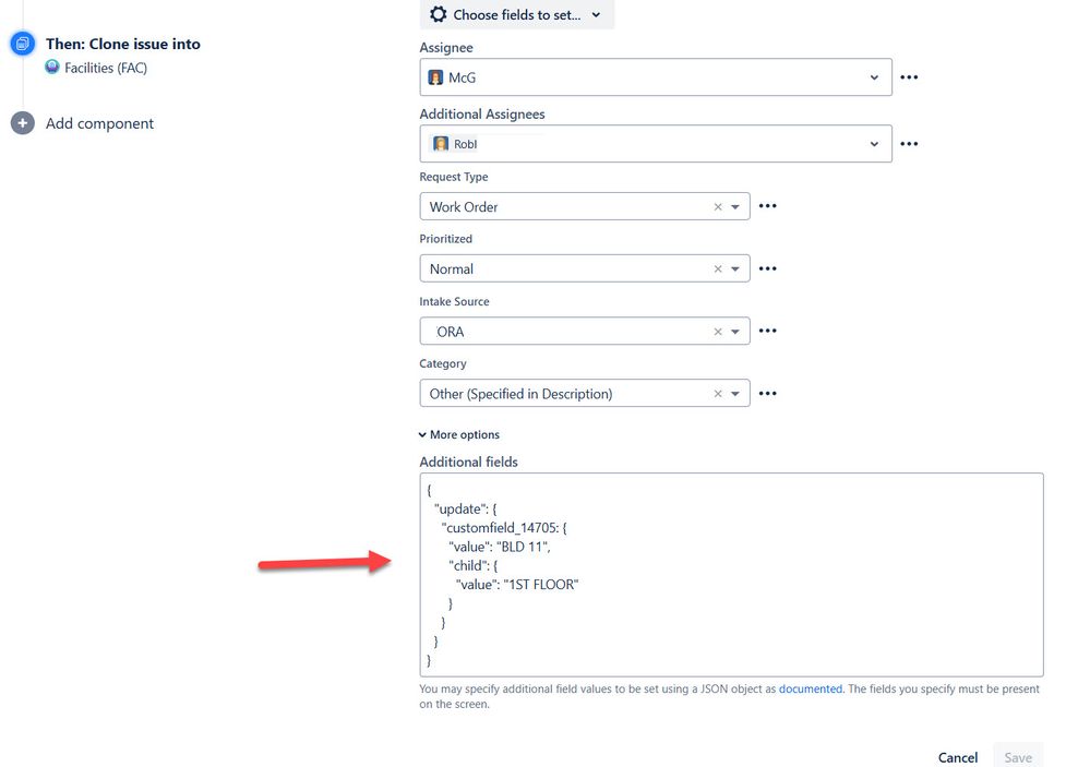

AndreH
June 24, 2025
I figured out the issue, the trailing brackets were the cause ] and }}}
This code works
"fields": {
"customfield_14705" : { "value": "BLD 11", "child": { "value" : "1ST FLOOR"} }
Trudy P Claspill
June 24, 2025
You are missing the closing double-quotes at the end of he custom field name.

Trudy P Claspill
June 24, 2025
In the image you provided there were no "]" (square brackets). The only error was the missing quotes.
