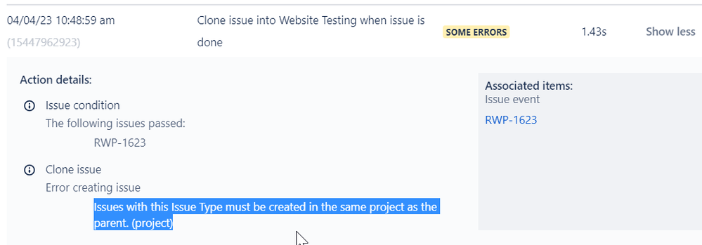

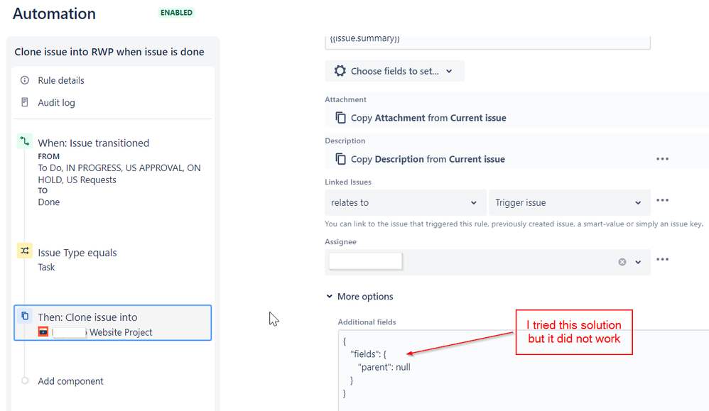

I have 3 team-managed projects: Design Project, Dev Project, and Test Project. When an issue is done in the design project, the issue needs to be cloned into dev project. Also, when an issue is done in the dev project, the issue needs to be cloned into test project. I have the automation but it fails. I will add the screenshots. I am open to any suggestions, thanks.
Design Project Automation:
Design Project Automation Fail:

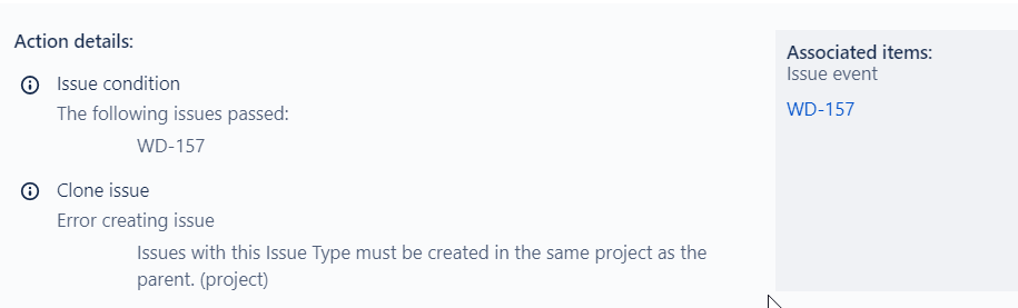

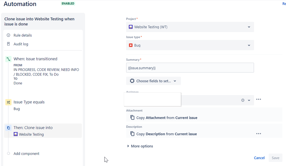

Dev Project Automation:
Dev Project Automation Fail:

Yes, I research the fail and I found the additional field input as a solution, so I tried it but it didn't work. When I delete that, the fail is not changing.
I think the problem is with the Clone and not the linking. It sounds like you are trying to clone an issue in project ABC that has a parent value of ABC-123 for example. But you are cloning the issue into project DEF. It is trying to create the clone and add ABC-123 as the parent of the issue that should get created in project DEF. But that is not allowed. You have to have a different parent for the cloned issue - one that is in project DEF.

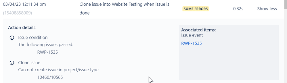

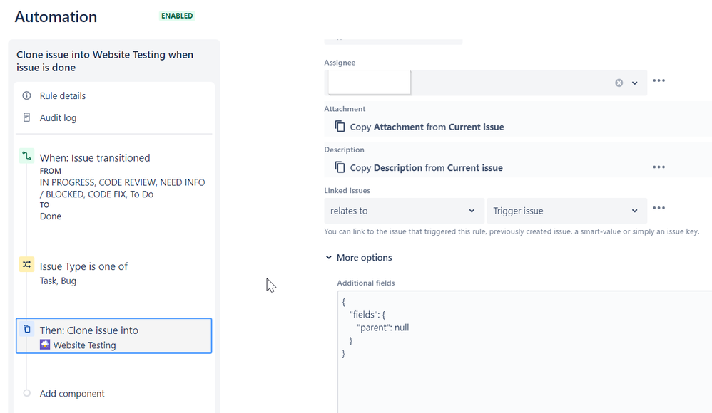

I updated it as you said. It failed again with a different type of error.
Automation and fail:
