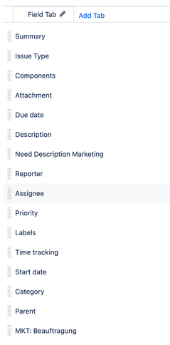

After i searched for every field Configuration, i found out that the description was removed from the create Issue Screen.
That was the mistake.

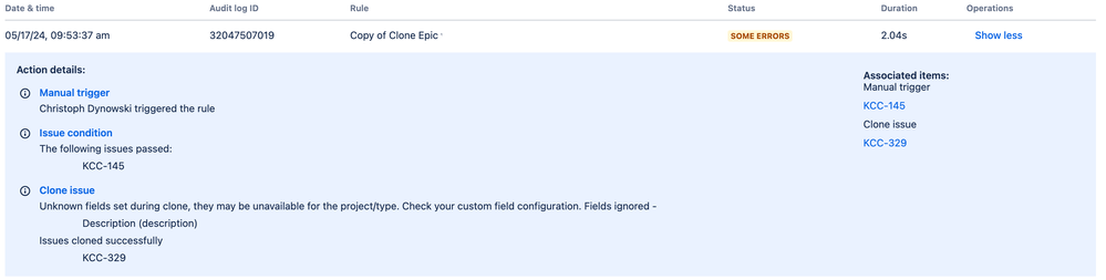

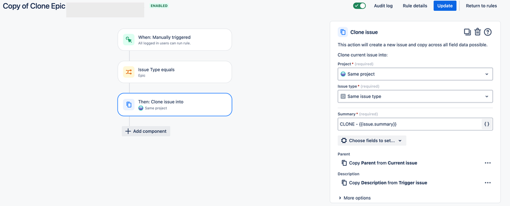

Cloning Epic
To reduce the complexity of the Automation, i created a new one that should just clone an Epic with all prefilled Fields like Description, Assignee, Reporter from the Template KCC-145.
In Jira Software the Automation works perfectly, in Jira Work Management i get the issues with the Description.
Exptected Result:
- clone the Issue KCC-145 with all prefilled Fields.
Bug:
- The Descirption is Empty
Bildschirmfoto 2024-05-17 um 10.11.31.pngBildschirmfoto 2024-05-17 um 10.11.19.png
Also checked if it could access the Description field incorrectly. There is only one Field Called Description and its the default Field from Jira.
I can't find a difference between Jira Software Description and Jira Work Management Description.

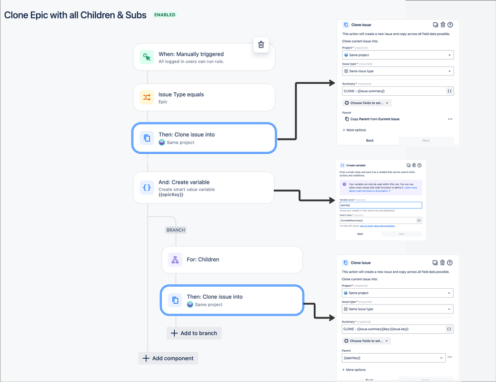

The whole Automation with Childern & Sub Tasks just FYI.
Cloning the Epic and Childern (Tasks)
Exptected Result:
- clone the Children with all prefilled Fields
Bug:

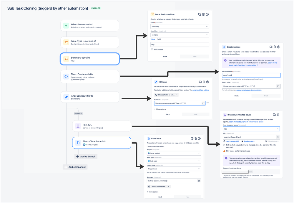

The Rule to Clone the Epic and Tasks:

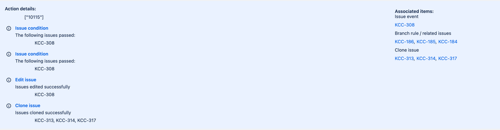

The Rule to Clone the Sub Tasks for each cloned Task:
Exptected Result:
- clone the Childern with all prefilled Fields
Bug:
