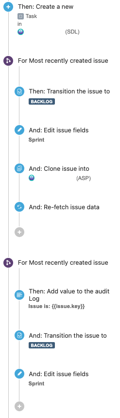

After hours of fiddling around it just won't work that way. I changed branch types and positions of them up an down. The issue I see is that the branch "All created Issues" and "Most recently created Issue" are not working as defined.
Below you can see parts of the rule. underneath I simply use another Branch of type "All created issues" and create sub-tasks for each one. Doesn't work. The outcome are two issues and one of them (the top and first one created) incl. the needed sub-tasks. The other one doesn't.

Based on the configuration in your screenshot, I believe you expect the branches to wait for one another, thus allowing the "most recently created issue" and "all created issues" to be aware of the issue creates that occur inside branches. This is not the case.

The first branch you show would seem to be the third bullet (single issue), and so run inline and block the rest of the rule processing until completion.  And you clone an issue in the branch.  I believe that your re-fetch action has nothing to do with the created or cloned issue, but instead refreshes for any originally triggering issues.
What are you expecting the scope of the next branch's "Most recently created issue" to be:
  • the first created task in the SDL project, or
  • the cloned task in the ASP project?
What do you observe happening in the audit log entry you have in the second branch?
