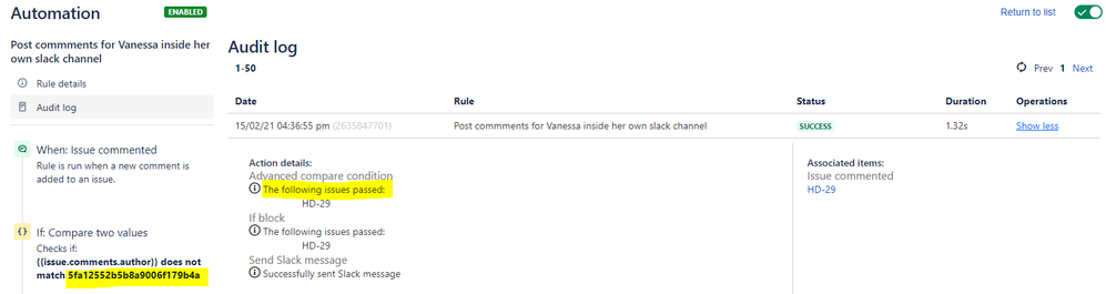

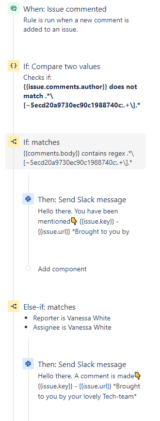

This is all of the automation.

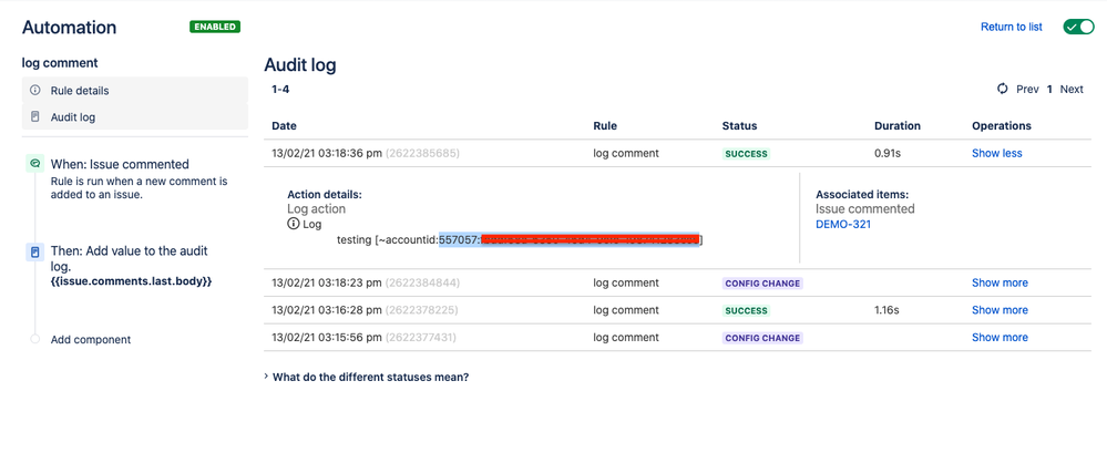

You can figure this out by creating a simple rule which sends their account id to the audit log by logging a comment which mentions them:
After that, use that exact account id in the regex:
.*\[~accountid:557057:fdddddd-6633-46a3-9acf-123456789da2\].*

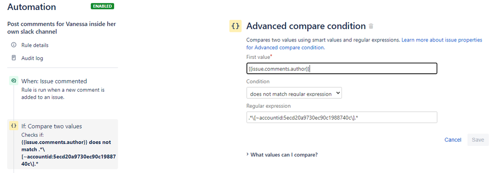

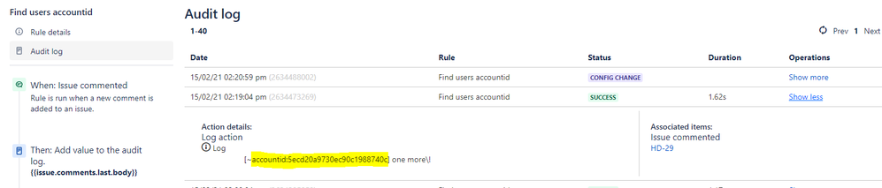

It seems to be the same AccountID as I tried earlier, although it doesn't seem to match what you described it should look like.
I have tried to update the RegEx with "accountid:...", it still just passes everything. Is there another way I can achieve my goal of not letting it pass a comment from a specific user?  Or do you have some other comments on what I do wrong?

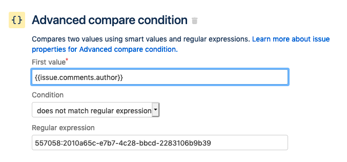

I'm not sure why you need all those extra things in your regular expression. Mine worked just fine like this:
