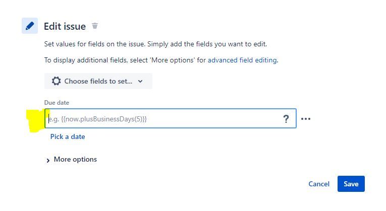

David Freitez
August 23, 2022
Hi @Penry John
First of all, welcome to the Atlassian community.
Regarding your question, Automation grants the use of Smart Values.
In your case, it will fit the use of {{now}}
Here is documentation so you can check further regarding the format you need:
https://support.atlassian.com/cloud-automation/docs/jira-smart-values-date-and-time/
Also, you don't need to use the advance options, you can use the smart value like in the following example:
Kindly review my comment and let me know if you need further help.
