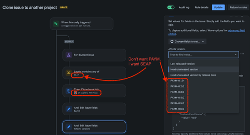

TLDR: When manually triggered to clone issue into another project, how do i add the next unreleased version to that ticket?
Using edit issue field fix/version only shows the current jira project, not the project i cloned into.

Now I'm trying to add the next unreleased version from ADB into the fix/version field, but it only shows Next Unreleased Version for project PAYM.

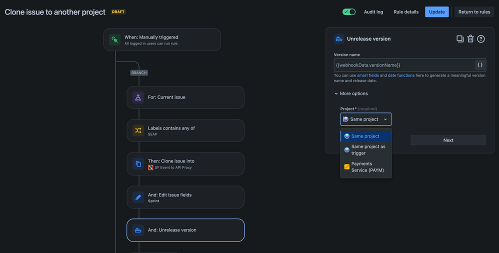

I see the Then Action: Unrelease Version but I'm not totally clear on what smart fields to put there if i don't know the version name.

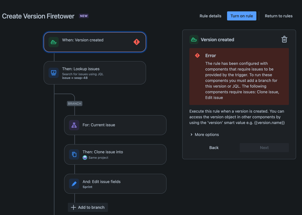

Okay, so i've decided to reverse things a bit. Originally I was having the dev manager add a label to the template review ticket in his main jira project then run the automation which would clone the issue into the appropriate jira microservice project and add it to current sprint. Then repeat that for each microservice.
However, he's already going into several different jira projects to create these versions in the first place, and from your comment above it seemed to me i should just automate creating the review ticket once he creates the version. Rather than a dummy ticket.
The downside of this approach is that i'll need to setup and maintain the automation in a few dozen jira projects rather than just one. But it's probably worth it.
But I'm stuck.
I've created a template issue seap-48 to then clone once a new version is created, but getting the following error. Do i need to use the advanced branching or do i have the branch in the wrong spot?
Bill Sheboy
May 24, 2024
First thing, sorry for the long reply as this will take a bit of explanation.  You can skip ahead to "Back to workarounds" for more ideas.
The error is describing the problem...(in a roundabout way :^) The trigger is for a version, and that provides no issues to the rule: thus the branch on current issue cannot find it.

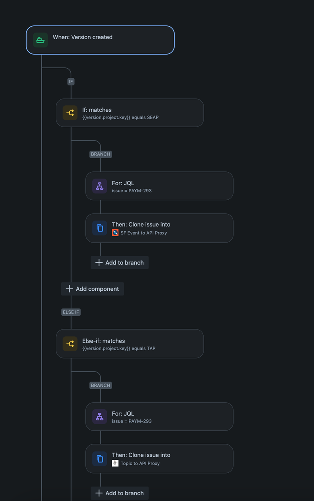

  1. for a known set of projects, use if / else conditions
  2. for an unknown set of projects, call the REST API
#1: for a known set of projects, use if / else conditions
  • trigger: version created
  • if / else condition
    • smart value condition
      • first value: {{version.project.key}}
      • condition: equals
      • second value: project A's key
    • branch: on JQL to your template issue SEAP-48
      • action: clone issue, selecting your project A
  • else / if
      • condition: equals
      • second value: project B's key
      • action: clone issue, selecting your project B
  • ...repeating for each project

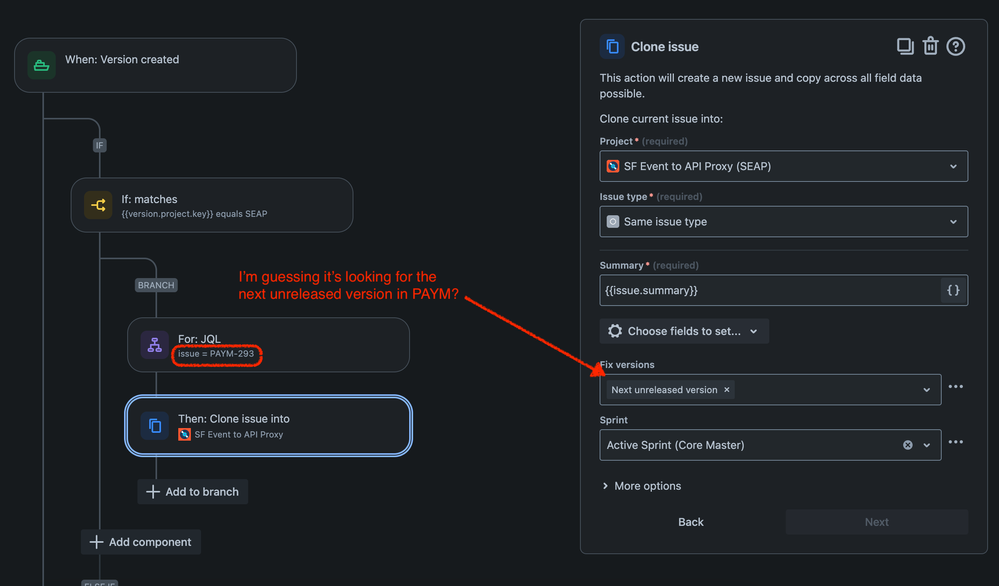

#1 workaround with if/else works just like it should, so i'm going with that. Now in your example, you have one template issue (SEAP-48) being cloned into the multiple projects. That works and it successfully places the cloned issue into the next unreleased version. However, it's not able to do that if my template issue isn't within SEAP.
The workaround that I've tried on a few projects is to create a template issue within each project and then clone and add to the release which seems to work correctly. I just want to avoid creating 30 different clone tickets, one in each project, so i thought I'd ask you first before doing that work.
My template issue is PAYM-293. Is it looking for the next unrleased version in PAYM project?

For the template issue, if that issue's project is in the scope of your multiple-project scope rule (in the rule details), it can be accessed for use in cloning from one issue in one project.
Now, the messy part: my very first post in this thread appears to be correct about the need for the REST API...
After some testing I found when branching to an issue (e.g., PAYM-293) that issue's project's versions are used in the Clone Issue action for things like "Next Unreleased Version".  That will fail to create issues in any other project as the versions are project-specific.  It does not matter which project is selected in the Clone Issue action.
I believe the only way to do this scenario is to call the REST API to get the next unreleased version for the specific project into which the issue is cloning, and then use advanced edit with JSON to set the version.
