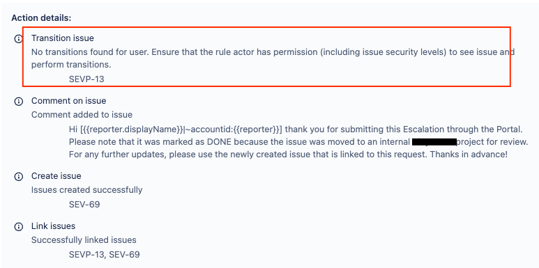

This week in our automation, where the Actor = "Automation for Jira" is failing with this in the logs.
Never had an issue with this before.

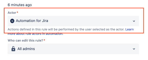

As far as I can tell, "Automation for Jira" is a default rule actor.
I don't think it would be affected by anything done to regular user permission schemes. I can't see it in the list of Users to check what group its in. You don't need to assign it any permissions in a project. But it has stopped being authenticated in some of our automation.

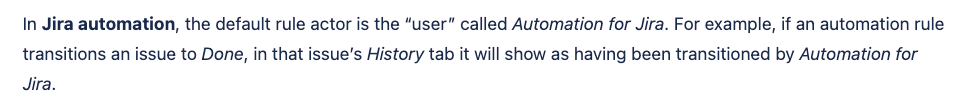

Snippet from https://support.atlassian.com/cloud-automation/docs/what-is-a-rule-actor/

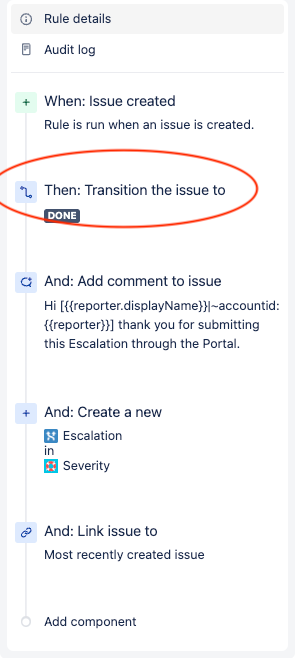

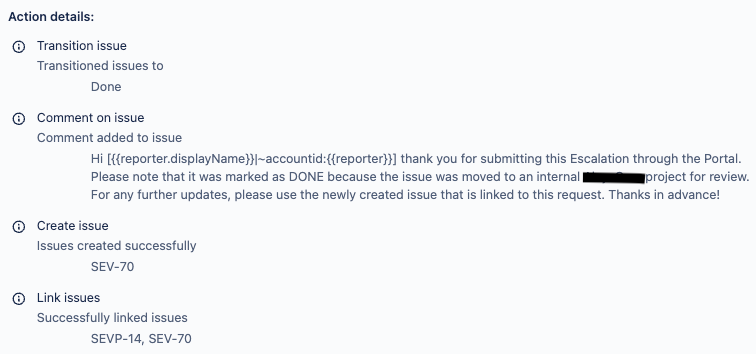

Would you please post images of your complete automation rule and of the audit log details showing the rule execution that failed?  Those may provide some context as it is possible that error is not focusing on the actual cause.
Jill Vieregge
October 6, 2023

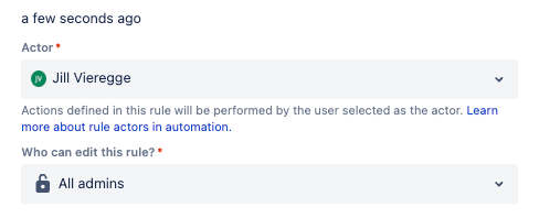

Case were it didn't work:Screenshot 2023-10-06 at 3.16.21 PM.pngScreenshot 2023-10-06 at 3.15.06 PM.pngScreenshot 2023-10-06 at 3.15.31 PM.png

Case when it does work (change Agent to me):
Screenshot 2023-10-06 at 3.17.47 PM.pngScreenshot 2023-10-06 at 3.18.12 PM.png

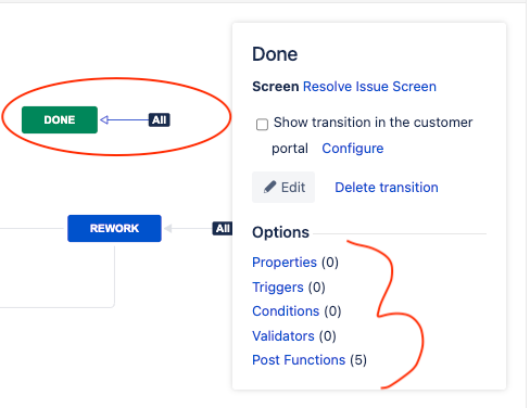

Please review the workflow for that issue type and look for any rules on the transition to Done which restrict which users can do so.
I suspect there is a restriction on your workflow to limit which users can move the issue to Done.  And, I do not believe the Automation for Jira user can be added to that transition rule.  (Or at least I was unable to do so when I just tried it.)
Jill Vieregge
October 6, 2023
To Done is a global transition . . . Screenshot 2023-10-06 at 4.16.59 PM.png

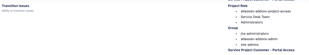

I thought maybe I was missing a group in the transition permission in the scheme; but here's what I have.Screenshot 2023-10-06 at 4.48.38 PM.png
