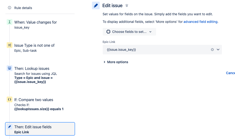

Hi all,
I am working on some more complex automation due to the lack of features of a Jira integration I setup. I am really stuck!
I would like to use automation to reference a field trigger when the field changes, query for that field input (should be an issue id) and then create an epic link to that issue id
Note: The issue id (issue_key) is being manually entered on the vendor side and then will carry over to a field called "issue_key" when an issue is created via the Jira integration with the vendor.
Perhaps there is a better way but I figured it was worth getting other input on how to tackle this.
Trudy P Claspill
December 3, 2022
If I have understood your requirement correctly, this rule should work. This assumes the issue that has the "issue_key" field is in a Company Managed project, as the Epic Link field is not used in Team Managed projects.

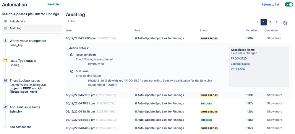

Thank you for your response! I found that with some tweaks this rule works, but only when I manually update the issue_key field. Which is great if someone linked the wrong epic and needs to fix it.
To tackle this I copied the rule and changed the trigger to be When: Issue created
Looking in the audit log I now see that field value for issue_key is nested in ' ' do you know how to remove those before the final step of editing the "Epic Link" field?
EDIT: looks like the first version of the rule did work it just took some time to run. However, the same error occurred and I will still need to remove the ' ' around the value.

What do you mean that the value is getting nested in quotes? Can you provide a screen image?

December 6, 2022

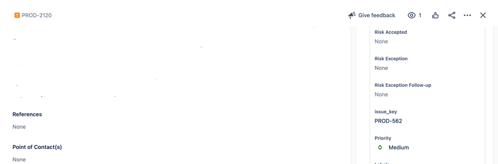

Can you show me a screen image of the issue PROD-2120 showing the issue_key field?
Can you show me a screen image of PROD-562 showing that it is an Epic type issue?

Screen Shot 2022-12-06 at 2.13.44 PM.pngScreen Shot 2022-12-06 at 2.15.30 PM.png
