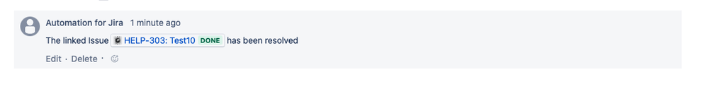

I have an issue here whereby an automated comment from user: Automation from
doesn't trigger an automated status change.

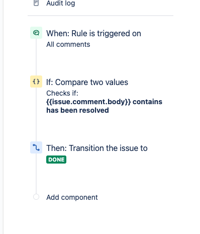

I have the following automation in place which I've successfully tested with a manual comment from myself and works fine. However when the automated comment above is triggered it does not go on to trigger the status change.
I've tried several variations without luck.
for example: using
{{comment.body}} contains XXX (some variation of the words in the automated comment)

{{comment.body}} equals XXX (added the exact automated comment in picture 1)

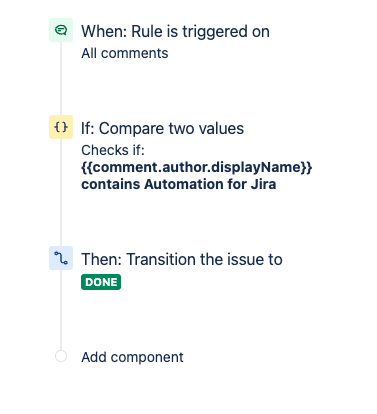

{{comment.author.displayName}} contains Automation for Jira

I have had success with checking some words in the comment. Here is a screenshot of Condition that works for me.
Maybe switch out my words of "I approve this ticket" for "has been resolved".
Hi @Sol
Yes, and...to John's suggestion:
Please note the comments smart value is a list, and that John shows a check on the last one added. It is possible your condition is trying to match on a different comment body, so please try {{issue.comments.last.body}} or using the change log for the specific changed value.

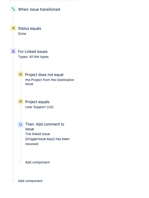

I've tried both of these methods and it doesn't seem to trigger. My suspicion is the fact the comment is automated. For wider context the workflow I'm trying to configure is as follows:
Maybe there's an easier workaround here but just cannot get this last automation to be triggered. as mentioned when commenting myself it triggers fine and sets to done. But for some reason doesn't like the automated comment or the Automation for Jira user that makes the comment...

Ah, so the trigger never fires at all? If that's it, go to the Rule Details page and click the box under the Allow Rule Trigger heading.
Save and publish and that should do it.

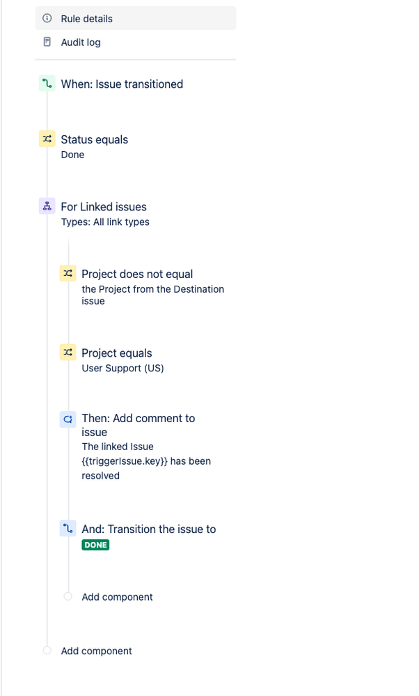

I also noticed that I could also just add a second action to the initial commenting rule to comment AND change the status of the linked issue:
Since this is a global rule I was a bit worried this would affect other projects but with the condition of the only project (US) that should be enough, I think?

Yes it will only update those on the US project, but if this is global, this is going fire when every issue in your system moves to Done because that's the initial trigger!! That's a lot of global executions!! You might want to consider turning it into a scheduled trigger and only running it once a day or a few times a day if you need faster resolution.
