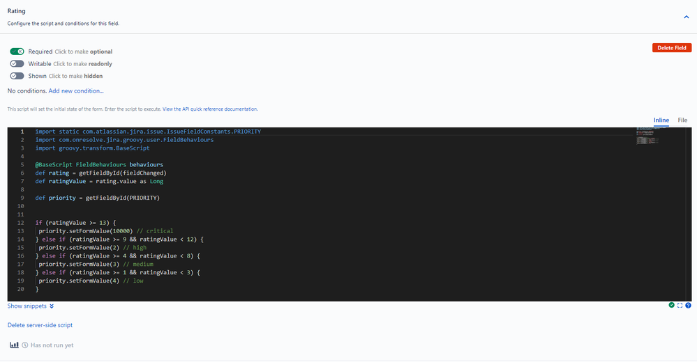

Modified to the below, but doesn't appear to work.
import static com.atlassian.jira.issue.IssueFieldConstants.PRIORITY
import com.onresolve.jira.groovy.user.FieldBehaviours
import groovy.transform.BaseScript
@BaseScript FieldBehaviours behaviours
def rating = getFieldById(fieldChanged)
def ratingValue = rating.value as Long
def priority = getFieldById(PRIORITY)
if (ratingValue >= 13) {
 priority.setFormValue(10000) // critical
} else if (ratingValue >= 9 && ratingValue < 12) {
 priority.setFormValue(2) // high
} else if (ratingValue >= 4 && ratingValue < 8) {
 priority.setFormValue(3) // medium
} else if (ratingValue >= 1 && ratingValue < 3) {
 priority.setFormValue(4) // low
Also to note, my custom field Rating does not appear on create screen, despite being in scope, being added to field configuration, and being added to field screen

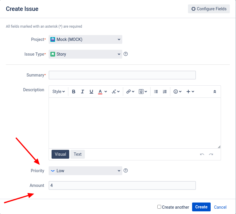

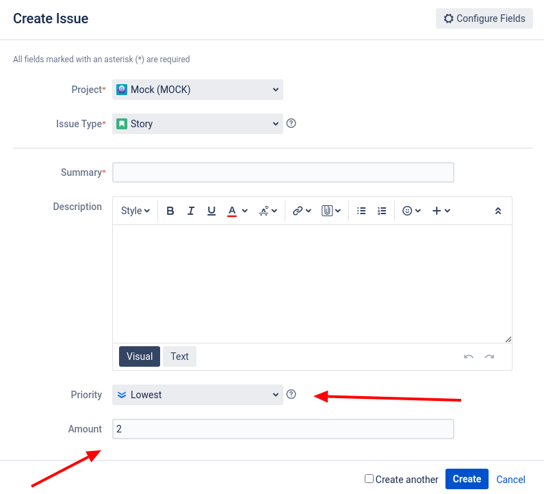

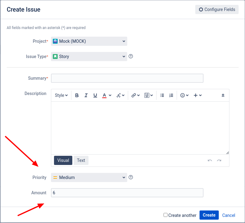

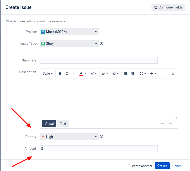

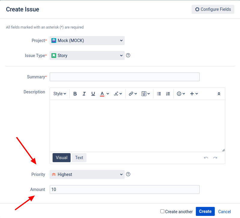

Below is a screenshot of the Behaviour configuration:-
Below are a couple of test screenshots for your reference:-
If you observe the screenshot displayed above, you will notice as the number field is updated, the priority field is updated accordingly.
I hope this helps to answer your question. :-)

Adrian_Avalos
May 17, 2023
Hi @Ram Kumar Aravindakshan _Adaptavist_ here is screenshot of behaviour.
And Rating custom field is on Create, Edit, and View Screen, however it's not visible on Create screenRating Behaviour.PNGRating Custom Field.PNG
