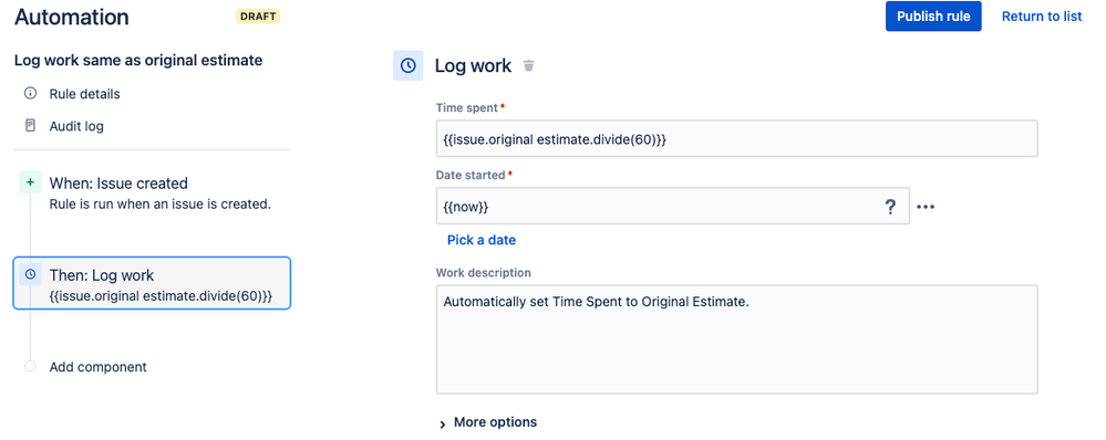

The basics of the rule for setting the Time Spent when the issue is created would be
Trigger: Issue Created
Action: Log Work
 - Time Spent: use smart value for Original Estimate
However, when Original Estimate is stored in the database it is converted from what you enter in the UI (i.e. 8h) to seconds (8h = 28800). And Time spent is stored in minutes. So, you would need to include in the rule a conversion of the Original Estimate converted value from seconds to minutes.
You might want to add conditions to constrain this rule to running for only certain types of issues.
If you allow the Original Estimate to be changed after the issue is created, you would need a separate rule to trigger on the value being changed. And you might need different conditions and actions in your rule. For example the Log Work action makes another time entry. If the Original Estimate is changed then you would end up with two time entries, not one time entry for just the current value of Original Estimate.
