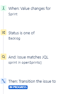

Can do it with Automation, will be something like the below -
You might not need the condition for sprint in OpenSprints() but give it a bash and see what happens.

Thank you for your response. I'd like to explore this option more but somehow it's failing and I don't know why. The idea is there -  that whenever a ticket with a 'Backlog' status enters an active sprint (regardless if it's a newly created sprint or anytime within the time of the sprint), it will transition the ticket status automatically to 'TO DO'.  - so I'm not sure why it's not working.

Please show a screen image of the rule you have and the details of the Audit Log for when the rule ran.

 I tried without the  sprint in OpenSprints() and it worked
