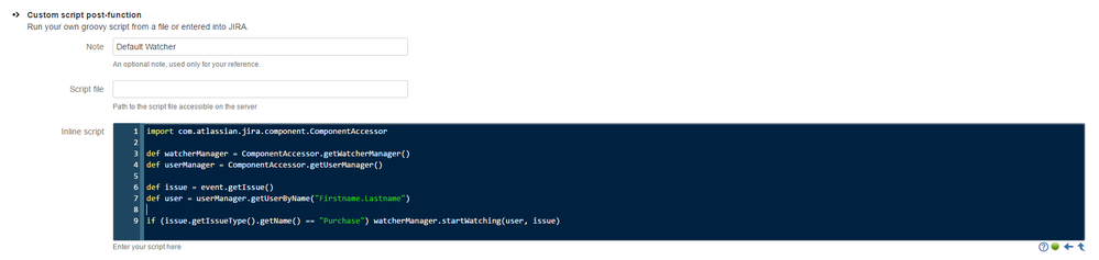

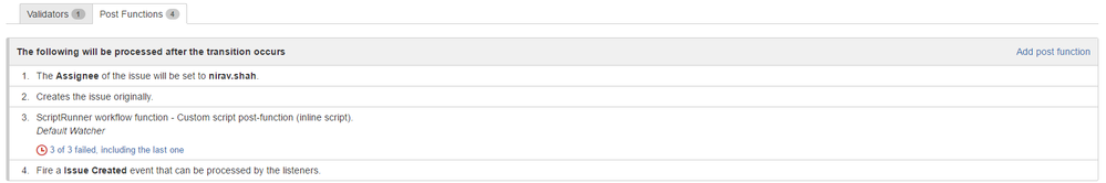

Jigar D Patel
May 31, 2017
Here is the script I am using. Ofcourse, I am using logon name where it says firstname.lastname but it isnt working for me.
