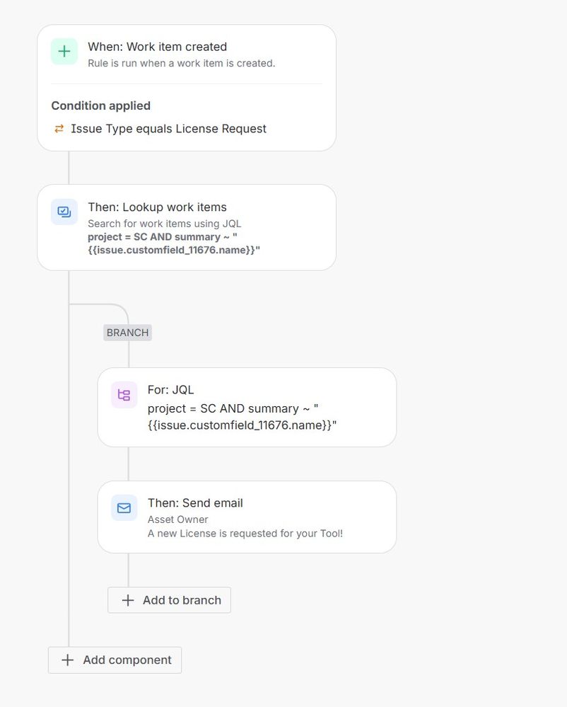

i am currently working on an automation that automatically adds request participants to the trigger issue.
The trigger issue is an ITSM request via the portal. When the request is created the automation looks up related issues in a JIRA project and sends notifications to the user selected in the field "Asset Owner". So fine so good.
Now i want the users in the field "Asset Owner" to be automatically added as request participants to the trigger issue. How do i have to edit my current automation? (See image). Thx in advance.

I have a question: According to the JSON expression the participants field would get updated with the value of the field of the trigger issue..right?
Maybe i am misunderstanding this but i wanted the participants field to be updated with the asset owner field values. The asset owner field is not in the trigger issue (ITSM request) but in the "Look-Up" Jira issue in the other project.
Thx.

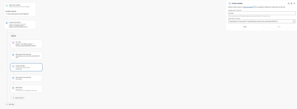

Hey,
thanks. But honestly i don't know exactly what to do. May i ask you to sent me a screenshot of a "Test" automation you build that does exactly what i want? I fear that it is a bit too complicated without actually seeing it...
Especially the last step "update" is confusing to me.
In the image you can see what i currently created in the rule. Thank you very much. Much appreciated. Screenshot 2026-04-21 100249.jpg

1) Which work item are you trying to update: the trigger one or something else?
2) Which work item is the source of custom field to update the target work item to update (from question #1 above)?
Let's assume you want to update the trigger work item and get the source data from another one.  In that case, the rule would not use branching.  Instead, use the Lookup Work Items action with a JQL expression to find the source data, and then build the JSON to update the trigger work item with a Edit Work Item action.
And, please carefully re-read my first post in this thread: you are using the Work Item Create trigger, and because that has racetrack timing problems:
  • Add a Re-fetch Work Item Data action immediately after the trigger
  • Never use conditions inside of triggers as they will work unpredictably because of the racetrack timing problems.  Instead, add the conditions after the re-fetch action
Thus, the rule outline could be:
  • trigger: work item created
  • action: re-fetch work item data
  • condition: to check the issue type
  • action: lookup work items, to find that source field
  • smart values condition: to confirm the lookup found one-and-only-one item
    • first value: {{lookupIssues.size0}}
    • condition: equals
    • second value: 1
  • action: create variable to build the JSON expression using the {{lookupIssues.first.yourCustomField}} ...
  • action: edit work item data, to use the JSON to update the trigger work item
Marcel Jünge
April 24, 2026
Hi,
i tried a few things out and finally it worked. Thanks four your help.
