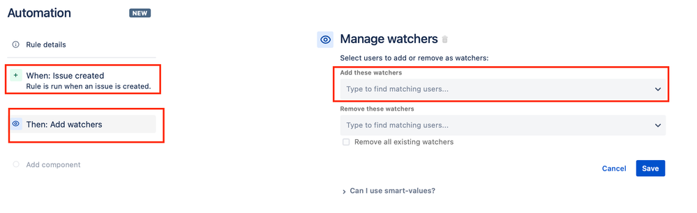

May be is more easy, create a new automation just like that
After then, the email notification working with the "Notification Scheme" for Assignee, Reporter and Watchers.

Claudio, this sounds like a great solution. I am not sure why I didn't think of it. Maybe because it is so simple :-). Thank you very much for pointing me to the right direction.

The answer posted by @Claudio Gonzalez will add uses to an issue as Watchers but doesn't change the notifications that are sent to Watchers.

If #1, then Claudio's answer and my answer are the same - Automation can be used to add a static set of users as Watchers to every issue created.
