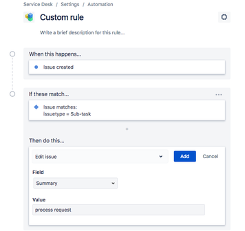

If that's the case, you can use the Automation feature of JIRA Service Desk to configure it:
1 - Navigate to your Service Desk project > Project Settings > Automation
2 - Configure a rule like the one below, replacing the parameter issuetype = sub-task by the type you are configuring (process request or service desk):
P.S: This feature is only available on JIRA Service Desk. For JIRA Core/Software projects, you will need a plugin to configure this automation.
