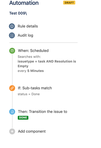

Hi @Stefan ,
With the help of Automation for Jira app you will be able to configure your requirement and please find below sample rule for your reference.
Hope the information helps.
--Ravya

One more question: Is this possible with the "lite" version of Jira Automation?
Ravya
November 26, 2019
I guess "lite" version might not be useful for this scenario as we gave time interval as 5 mins in the setup(refer above screenshot). Using lite version we can only trigger 300 events in a month. So depending on that we need to customize the automation rules.
