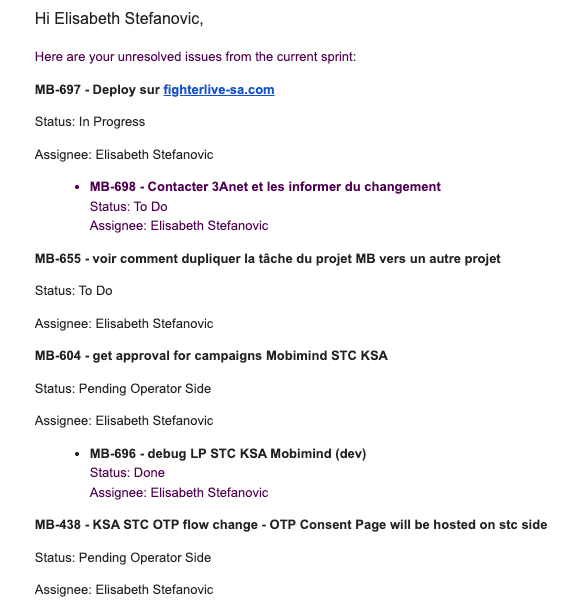

This current setup sends me a list which is very close!
But I still don't get the Subtask which is nested under a Task not assigned to me (MB-694), and I get the unwanted subtask (MB-696) which is Done and I only want unresolved issues.

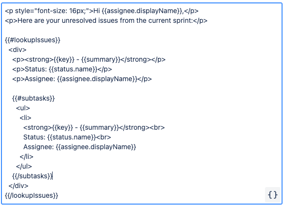

Also , in the email ChatGPT suggested trying #IF functions however I always get an error - if it's possible to achieve the results via functions in HTML , could you help me with ideas?

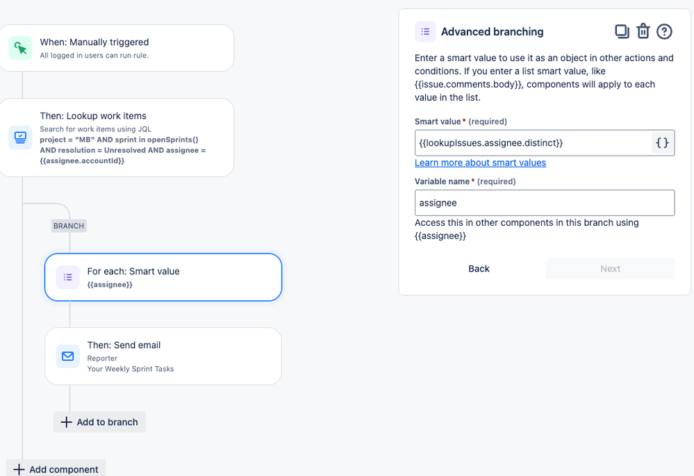

Hi @Elisabeth Stefanovic -- Welcome to the Atlassian Community!
First things first: do you ever expect more than 100 issues (not subtasks) to be in the active sprint(s) AND assigned to people?  If so, your scenario likely cannot be solved with a single automation rule due to the built-in limits.  Instead, you would need to split up the issues into sets to get under the limits.
Let's assume you are under those limits...
To find all of the issues in the sprint, part of your shown JQL could be used (ignoring assignments for a moment), and assuming all completed items are marked as Resolved:
project = MB AND sprint IN openSprints() AND Resolved IS EMPTY
And within each returned issue, their subtasks are also returned as a list.  Using that information, a rule could use the Lookup Issues action to first gather the above issues with their subtasks, and then parse them to make a combined list of assignees for advanced branching over the distinct ones.
The combined list of distinct accountId values for the assignees would be this expression that could be used in the advanced branch to find the assigned and unresolved issues for each person (with another Lookup Issues action):
{{lookupIssues.assignee.accountId.distinct.join(",").concat(",").concat(lookupIssues.subtasks.assignee.accountId.flatten.distinct.join(",")).split(",").distinct}}
How that works is:
  • for the lookup results, use inline iteration to get the assignee, accountId values
  • extract just the distinct values from that result
  • joining them together as a comma-separated list as text
  • concatenate on another comma to separate from the subtask assignees, which are found by
    • using nested inline iteration, for the subtasks in each issue
    • gather their assignee, accountId values
    • and use the new flatten function to merge those into a single list
    • extracting just the distinct values
    • and joining them again with comma separators
  • finally, the combined values are split back into a list, and distinct is used one final time
There would be additional steps if people can be assigned to issues which are not in the active sprint (or their issue subtasks).  That would require first finding the issue keys from the original lookup to help the search.

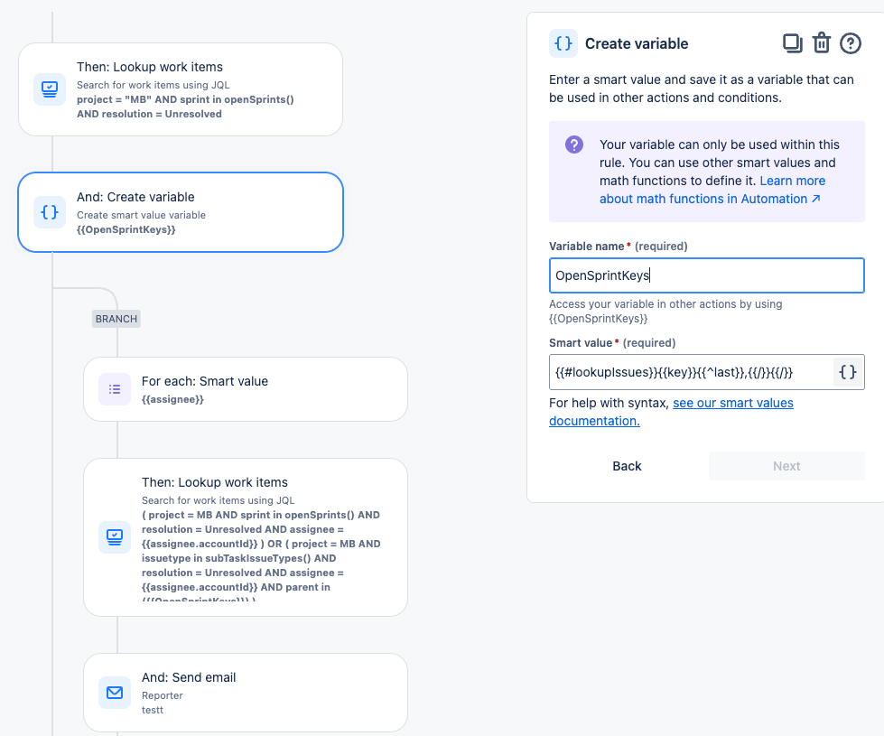

I have managed to keep the information about the unresolved issues in a variable , and from there it seems to be finally working.
I also have a specifity of the project : some of the assignees appear only in the subtasks, so ideally i'd need to branch from there. But I'll keep this for the V2 of my automation.
