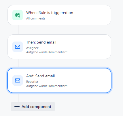

Hello,
i wanted to ask if anybody knows how to help mi with my Problem?
I will start with a picture to make it more clear:
So i want to make a automatic email when somebody comments the Issue, it works quite good already but my major problem is that when somebody comments the one who makes the comment also gets the Notification.
So is there a way that only the other Person who didnt make the comment get the email?
And maybe its important in this Projekt there are always only two people on one Issue (Reporter and Assignee).
LG Lukas

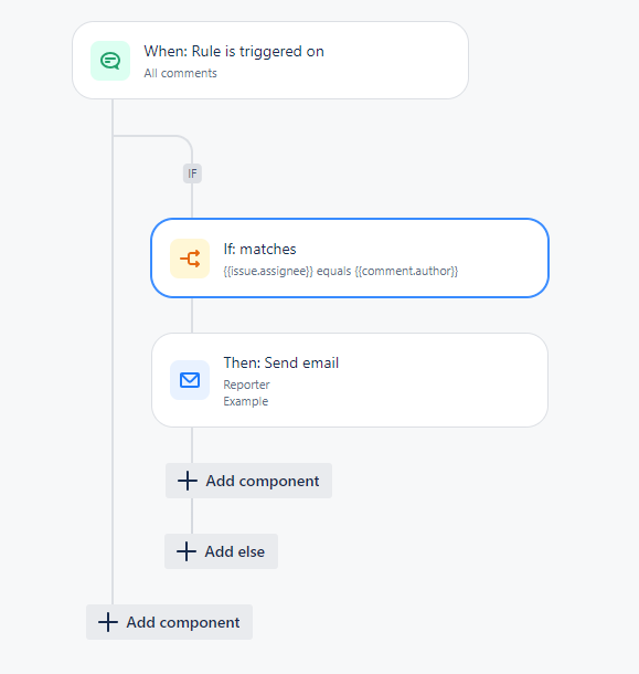

Jonas Fiener
June 3, 2024
The Answer above should be the way to go. Nevertheless you could do something like this, if its required: 2024-06-03 11_18_07-Window.png
Im not sure whether you can compare the users directly, or if you need to go via the id, but that would be the logic needed for the automation.
