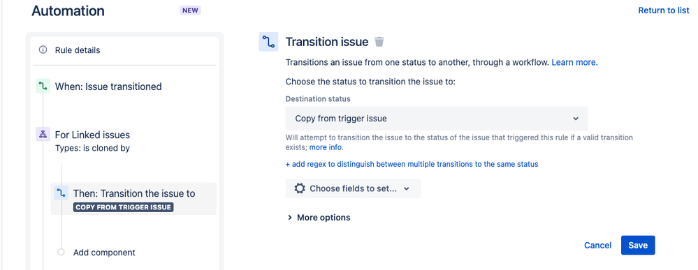

March 1, 2023
Hello Tamara,
Please clarify which issue's status change triggers an update to the other issue's status.
If you had issue ABC-123, and you cloned it to create ABC-456, would you want the change in ABC-123 to cause a change in ABC-456 or the reverse?
Would you want the status of the trigger issue copied to the other issue?
Are there any restrictions you would want applied to that scenario?
The basic structure for the rule would be similar to this:
In the For Linked Issues branch you would pick the link type (clones or is cloned by) that represents the cloning relationship between the trigger issue and the issue you want to update.
Tamara
March 1, 2023
Hi Trudy,
Here is the real case:
The created incident is the ABC-123 , which has goes through the "validated" state of the flow and this state is the trigger for it to be cloned to the other board as the ABC-456. But the developer is going to work on this clone and it will go through states like in progress, blocked or done. I need the ABC-123 to change the state as it changes in the ABC-456 - have I explained myself better now?
Is there any restriction that I want to apply to this scenario, once the ABC-123 is cloned to the other board, I do not have any restriction.
I remain attentive to your answer
Regards
Tamara
March 1, 2023
By the way, the automatism to clone the issue when it goes to "validated" state is already done and working, I am missing the part where the cloned task, when it changes state, updates the original one also to the same state as the cloned one.
Trudy P Claspill
March 1, 2023
Hello Tamara,
Thank you for that additional information.
In that case you would want the Link Type selected in the second step to be "clones", not "is cloned by".
Tamara
March 1, 2023
Thanks, I will try that configuration.
I will keep you posted.
best regards
Tamara-
