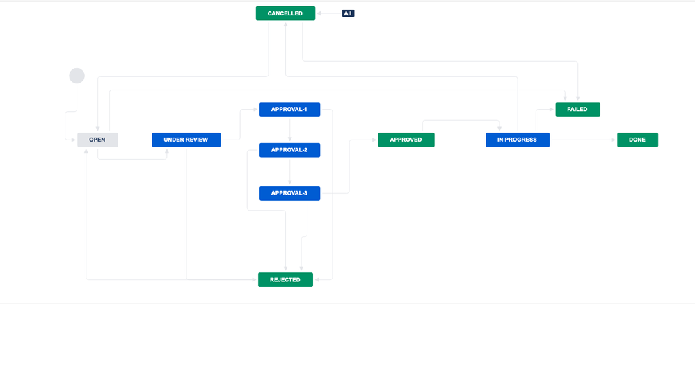

I want something of this sort. The thing is approval need not always come from a person it can be an automates state transition also. but once I reach approval 3, it should automatically transition to APPROVED state. I am planning to automate a flow and according to that I will pick all the tickets in APPROVED state.

So looking at this you do want a sequence of approvals.
While it might not be my preferred way of working you can easily do this using JSM by simply setting up each approval status as an approval step  (see my previous reply with the link).
If 1 is approved you'd simply go to 2 and then 3. and approved (or rejected somewhere along the way).
Easiest here would indeed to put 3 different approver custom fields too so you can define who needs to approve in which step.
To automate a step you will need to take a look at an automation to transition the issue immediately based on some kind of condition.

Ok so If I understand you correctly, using JSM each of the three approval status will have an approval step associated with it. So if Approval 1 is approved we go to approval 2, if not it will go to rejected. same for approval 2. and for approval 3 if its approved it will automatically go to Approved state?
Dirk Ronsmans
May 3, 2021
Correct.
This way does limit you a bit in that you can only go to the 2nd person when the first has approved but that also helps as in that you don't bother the 2nd person when the 1st already rejected.
If you however want to send it to all 3 at the same time and want the system to wait till all 3 have approved (or one has rejected) you could just use a single step and configure it with multiple approvers.
But from your use case I feel like 3 statuses seems more what you are going for.
