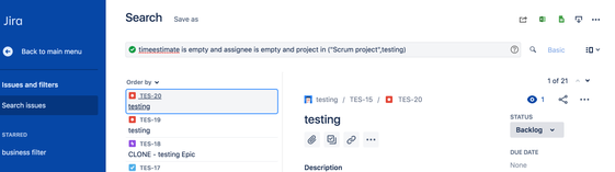

Basically, you can create a new board to track all the items of your Scrum projects, using the JQL filter of that board to specify what kind of parameters/scenario they should be reproducing to appear in the board, like time without any updates, Assignee, NO Estimated hours, etc.
You can also split the board by using quick filters, so you can display only the unassigned tickets, or the ones with on updates in the last 5 days, etc
To create a global board, you can perform the steps below:
- Go to your issue navigator > Create a filter to return all the issues you want > Save it with the name you want
- Back to your project, click on the board drop-down > Create a new board
- Select to create board from an existing filter and select the filter you created, following the steps of the client to configure it as you need
