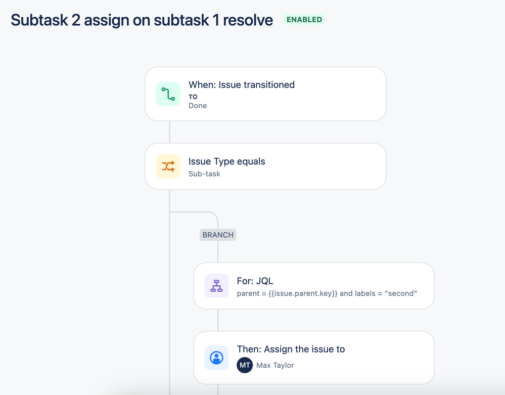

Thanks! I have added each subtask as a label (such as 1. 2. etc.). I am not an expert, but I know there is a way to do this. Can you help me create the JQL statement? TIA!
Fazila Ashraf
May 9, 2024
@Dawn Criswell , if you want to automate with this label logic, you can make an automation like below
