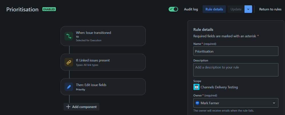

Hi,
I work with a lot of test cases and have automated much of the creation process. I now want to be able to automate the priority in order to change it when the issue moves to a new status and if the issue has linked issues.
ie:
Issue A has Issue B linked as a blocker or test. Issue A moves into In Progress status. Issue A's priority needs to change.
I can't seem to get any logic I try to work.

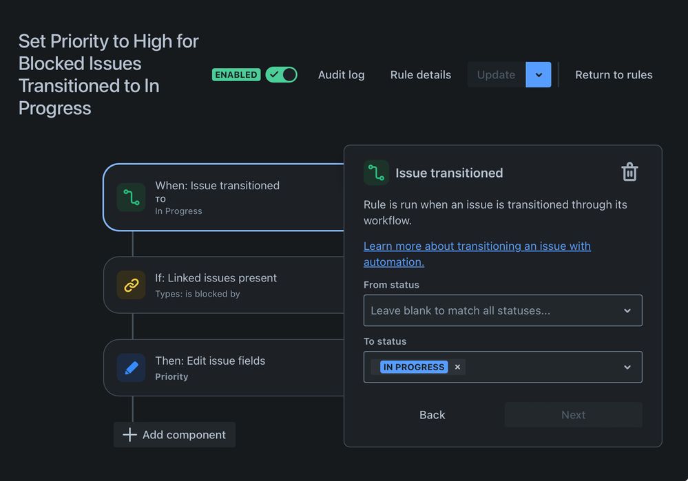

Hi @Mark Farmer , see if the following is close to your goal...
P.s. I see you are on Premium? If so I highly recommend trying out the AI feature for creating rules as I have found it quite useful.
Mark Farmer
February 11, 2025
Hi Jack,
I tried something similar and it was changing the priority of the linked issues rather than the ones where the status was changing.

Jack Brickey
February 11, 2025
Jack Brickey
February 11, 2025
Keep me posted if the above works
Jack Brickey
February 11, 2025
The above rule will only change the priority of the trigger issue not the linked issues. If you see something different please advise and share audit log.

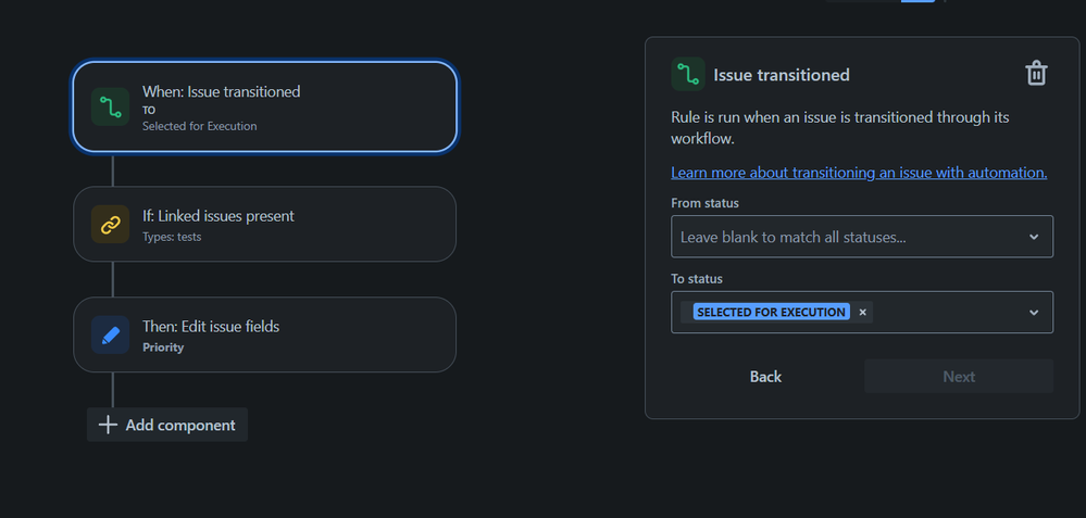

Mark Farmer
February 11, 2025

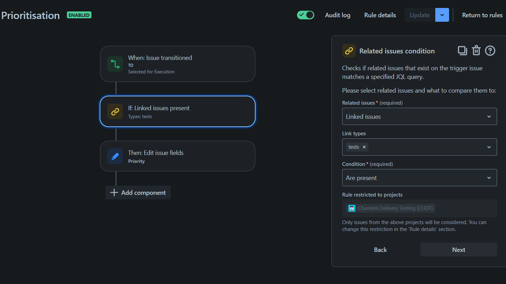

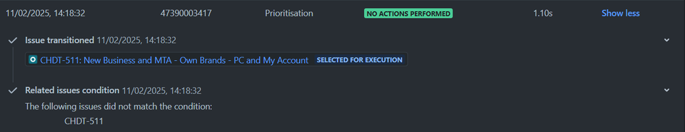

Hi Jack, I've changed to this rule and now nothing's happening. The rule runs but it seems to think the ticket (CHDT-511) doesn't meet the criteria. The linked issues don't change now though so that's a bonus.

Jack Brickey
February 11, 2025
Can you share the details of the condition component? Are you choosing a specific link type in that condition? Have you verified that the linked issues are of the type in the condition.
Mark Farmer
February 11, 2025

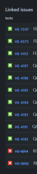

Mark Farmer
February 11, 2025
They're all linked as 'tests' and that's the condition I've aligned it to.

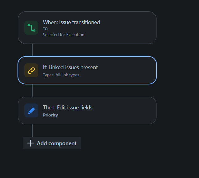

Could you try changing the condition to be any link type and test?
Mark Farmer
February 11, 2025
Jack Brickey
February 11, 2025
Hi @Mark Farmer , so I just did a test and it worked fine. one thing I note in your las image is that the linked issues are in a different project. Did you set the rule to be multi-project or global?

Mark Farmer
February 12, 2025
Hi @Jack Brickey I think this is the issue. I've not the permission to make the change but I've submitted a request to our admin team to change it to multi-project. Once it's done I'll come back and let you know!

Jack Brickey
February 12, 2025
Yes that is the issue for sure.
Mark Farmer
February 24, 2025
Hello! Finally got the update, adjusting to multi-project worked.

Bill Sheboy
February 11, 2025
Hi @Mark Farmer -- Welcome to the Atlassian Community!
What is the scope of your rule: single-project, multiple-project, or global?
A single-project scope rule can create / clone issues into other projects, but it cannot access them in any other way.  That is likely why no linked issues are found in your rule condition.
Please try working with your Jira Site Admin to change the rule scope to multiple-project, and select the specific projects needed.
Another possible cause of this symptom is link-direction not matching the condition.  You show the "tests" linkage.  What is the link name from the other direction?

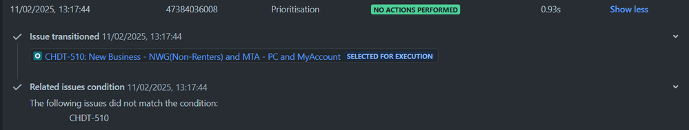

Mark Farmer
February 11, 2025
Mark Farmer
February 11, 2025
Apologies for the image surge Tobi but I thought it best to send everything relevant. @Jack Brickey to save duplication :D

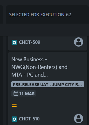

Tomislav Tobijas
February 11, 2025
No worries @Mark Farmer !
By the looks of the audit log, the only 'checked' issue was CHDT-510.
Are you saying that all those linked issues in HE project were updated/their priority was changed? Can you check (and/or screenshot) issue history for those issues?
Mark Farmer
February 11, 2025
It may have been a different variation of the flow I'd tried previous(there's been so many!) using this flow, the priority on the 510 ticket doesn't change when moving to Selected for Execution. If I have another CHDT ticket linked, it does.
