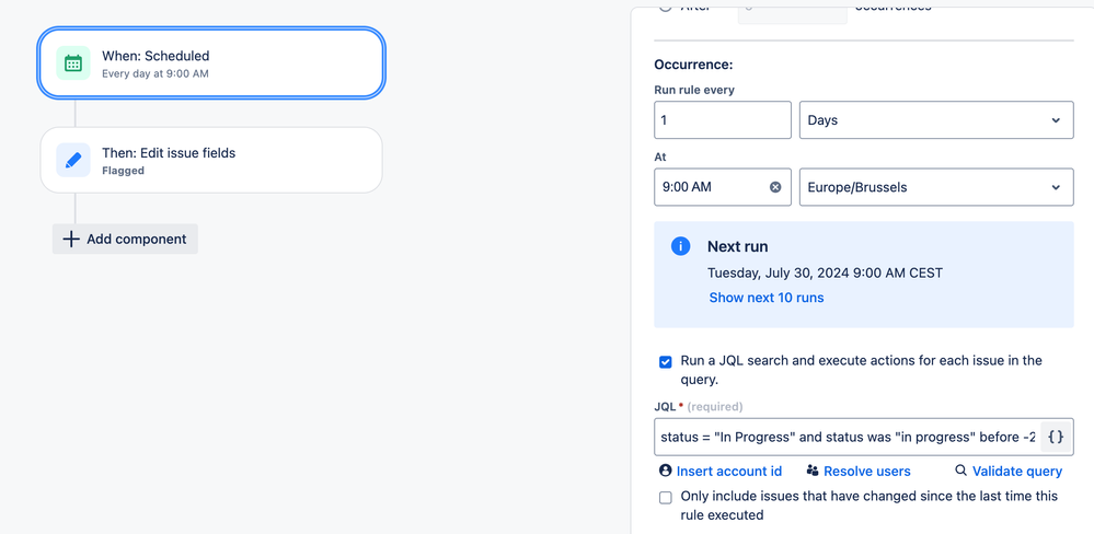

Hi @beth.sutton,
For help with automation issues, it is best if you could share (screenshots of) your current automation rules so we can better assess what might be wrong.
Having said that, you should be able to solve your use case with the following automation rule:
It uses a scheduled trigger, in my example running every day at 9:00 AM and running a JQL filter to select issues that have been in the In Progress status for more than 2 days (at 9.00 AM every morning). I then use an edit issue action to update the Flagged field.
The full filter I used in my example is this:
status = "In Progress" and status was "in progress" before -2d
and flagged != Impediment
Obviously, you can play around with the values I used for status, the number of days issues have been in that status and any other fields that may be better suited for your use case.
Hope this helps!

Walter Buggenhout
July 30, 2024
Hi @beth.sutton,
The best thing you can do is try to run your query in the issue navigator (either through the issues view in your project or from Filters > View all issues. If there is a mistake in your filter, you should usually get an indication there.
