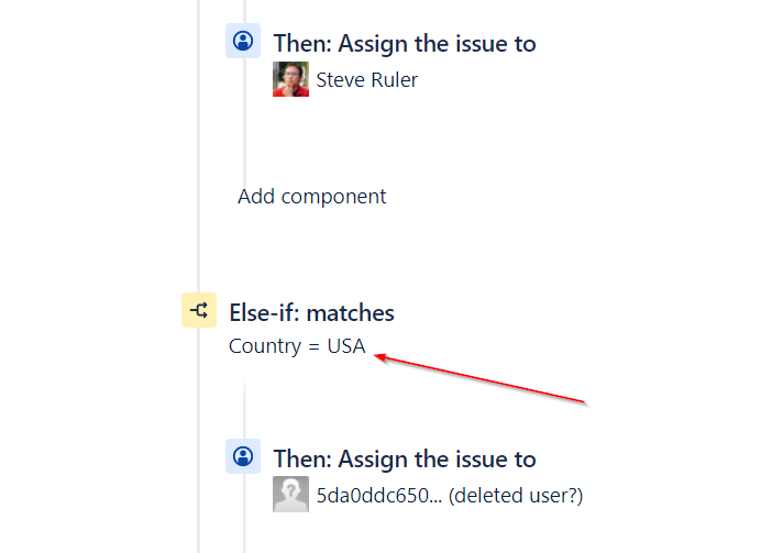

I was wondering if I could build an automation rule that handles tickets coming from a specific region, country?
We have several customers that are located in different parts of the world. I have already an automation rule in place that ads the organisation based on the 'domain' BUT the problem here is that all countries have the same domain (eg. "xxx.com") hence I cannot differentiate based on that field.
What I want to accomplish is the following:
  1. Certain tickets coming from certain regions/countries need to come in a different queue (low or high priority) and should therefore have a different SLA.
    • I have found an example that filters on the field 'country' but apparently this field is not known?
Thanks for the push in the right direction!

It's indeed a Service Desk thing that I want to accomplish like mentioned, so the idea to look at the organisation is probably the way to go...however here a problem occurred.
We build up the organisation field based on the reporter's domain. Eg. xx@onyx.be means the organisation would be Onyx.be and the reporter is automatically added to that organization.
But...this setup fails big time when we have clients that are scattered around the world (different continents) and all have that same domain. In those cases, I cannot automate that tickets that are coming from Australia should be coming in another queue than the ones that are coming from the USA or Europe.
