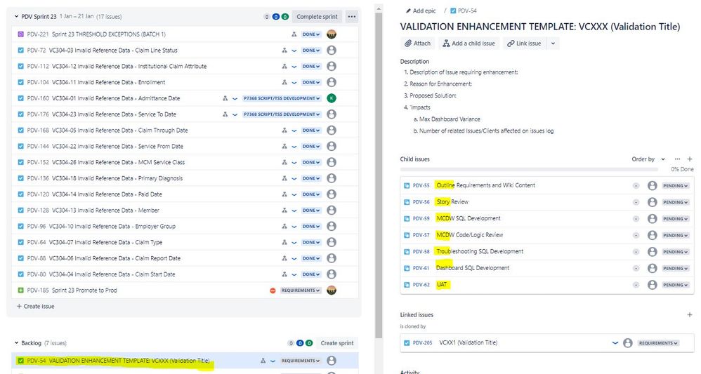

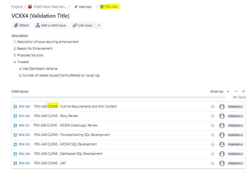

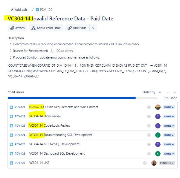

Hi @Mark Segall .  Here's a screenshot of the "template" Issue I created.  And you can also see the list issues in the current sprint.  The project's focus is the creation and enhancement of  Validation checks. So each task will have similar requirements and the same subtasks.  So I'd like to create the tasks by starting with this "template".  I've successfully built the automation remove "CLONE" from the subtasks.  Now I want to append the first 9 or 10 characters from the Parent task name to each of the subtasks so that when notifications go out for the subtasks and on dashboards, there's a clear indication as to which issue it refers.  The second screenshot shows the desired result (which I'd created manually).  Actually now that I think about it what would work best is to append the characters before the first space as the length of the VC# varies. Is there a formula I could employ for that result?
I didn't capture a screenshot of my initial attempt at this automation, but if I remember correctly what I got was a subtask named "Outline R Outline Requirements and Wiki Content" instead of my intended result: "VC304-14 Outline Requirements and Wiki Content"

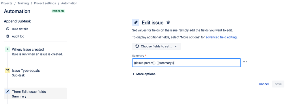

So yes this is totally possible.  So to be clear, you're not necessarily looking for 10 characters as much as appending the original issue key to the summary (at least that's the direction I would take because at some point that could become 11 or 12 characters.  Here's a quick sample rule:
...and for easier copy/pasting, here's what I put in the summary:
{{issue.parent}} {{summary}}

@Mark Segall Ok, I gave that one a try.  Getting warmer. But my automation to remove clone seems to have broken.  I tried adding this as a separate automation and then adding it as another step in my automation to remove clone from the title.  Both scenarios resulted in "CLONE" remaining in the title.  Is there a nuance that I'm missing? Do both need to be in the same automation step?
Mark Segall
January 27, 2022
Ahh ok.  Yes, tweak it like this:
{{issue.parent}} {{issue.summary.remove("CLONE - ")}}

@Mark Segall  Success!  Thanks so much!

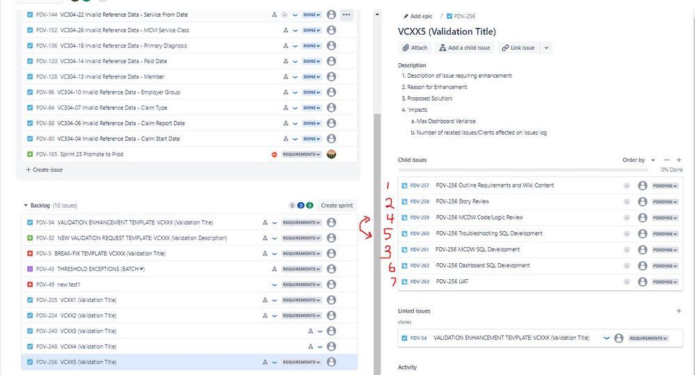

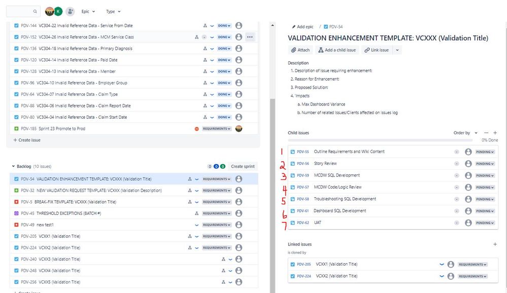

@Mark Segall  Here's an example of the problem I'm having with the order of subtasks in the cloned issue:  My "template" that I clone for creating new issues has the subtasks created in the order in which they need to be performed.  But when I clone that issue, the subtasks in new issue are not created in the same order. This seems to be a bug as I've found questions where others have encounter this but no found no solution.
The subtask sort order options seem to be limited as well, and I've also had trouble if with the order changing back key if I drag and drop them back to the correct order

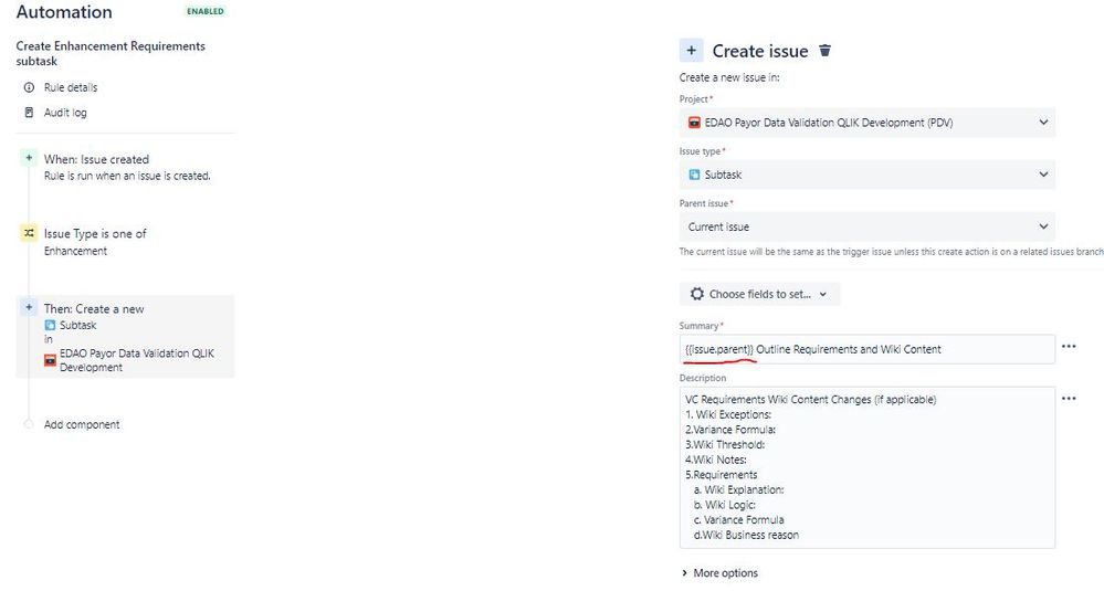

Tina.Henry
January 27, 2022
@Mark Segall Here's the automation I had set up for creating the first subtask when the issue is created.   I've inserted  {{issue.parent}} as the first part of the Summary followed by the subtask name.  When I create and issue everything works as planned except the parent key does not show up in the name.
Mark Segall
January 27, 2022
Solving what I believe is the quick one first... Since you're creating an issue, parent is not going to apply.  You're passing the current issue key to the newly created subtask so you would simply use this for the example provided:
{{issue}} Outline Requirements and Wiki Content

Mark Segall
January 27, 2022
As for the order, I understand now that you have a template issue with subtasks that you're cloning.  The only advice I have for ensuring subtasks are created in the desired order is to leverage automation to generate issues and corresponding subtasks.  You would basically have a rule with 8 create issue actions.  1 for your parent and then 7 to create the subtasks. The automation rule always steps through in order so you'd be assured that they're being created in the order you want.
