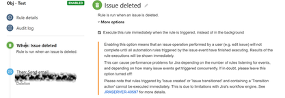

I chose the option :
(x) Execute this rule immediately when the rule is triggered, instead of in the background
I thought that it will be possible to check if the ticket has a specific label , and send an email with the key and the reporter and so on....

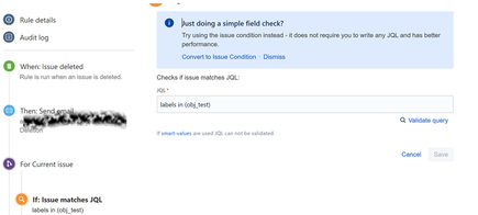

But, it's not the case as my automate failed saying that the issueKey doesn't exist !
This occurs in the JQL that check if the issue contains a specific label
This step is an "If Issue matches JQL, included" created a Branch Rule ("For Current issue")
To debug it I sent an email first, and then, I put the branch rule and send again an other email. The first email is working properly but the error occurs after.
Successfully sent email.
XXXXX-11157
JQL condition
No subsequent actions were performed since JQL condition did not pass due to error running JQL:
"(key IN (XXXX-11157) AND (labels in (obj_test)))" - An issue with key 'XXX-11157' does not exist for field 'key'.
Could you help me to understand my issue?

agnes BOURLON
April 7, 2024
Thanks @John  and @Bill Sheboy

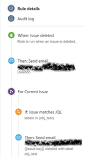

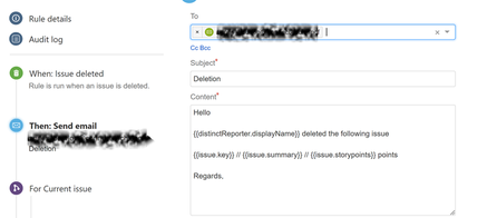

Here are the different steps of my workflow :
First step : Issue Deleted
2nd step : Email => OK
3rd step : If => KO
Here I got the error :
Please note that I got the same issue by moving the "If step" before sending the email
It seems that the key is available in the "email step" but not in the "check label step"....

Bill Sheboy
April 7, 2024
I wonder if some conditions (such as JQL condition) do not work on deleted issues because they actually run against the database's issue data rather than the issue data in the rule.
Please try removing the branch on current issue, and then testing the trigger issue smart values directly using the advanced compare condition rather than using the JQL condition.

(*) 1st email, I got this result
Objet : Deletion
Hello ,
XXXX-11233 // TEST - 2 // obj_test
