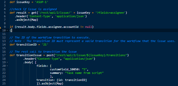

I'm trying to auto update a custom field and a system field during transition by using ScriptRunner in JIRA Cloud.
I'm want to use POST method. Take note that I've tried with actual value but keep getting error. I guess my body isn't correct. I'm new to Groovy. Kindly assist.
Please find below code.

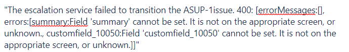

I've managed to solve this. I'm unable to use update custom fields in the transition as the fields were not available. I was unable to get the fields although I tried to change the screen types in workflow transition.
So I managed to use PUT method to update fields.

Hi Nic.. Thanks for the suggestion.. I'm trying to update the fields by using POST function when doing transition..
Please look at below script.
I got below error. Please assist.
