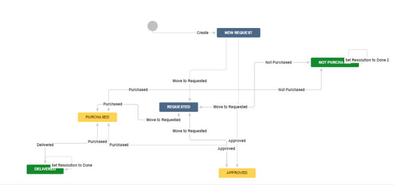

Hi -

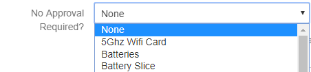

Our Purchase Request workflow needs to be updated so if users leave "None" selected in the "No Approval Required?" custom field, the issue will transition directly to REQUESTED.
Likewise, if something else (NOT None) is selected, the issue would go to APPROVED.
Currently, when the issue is created, its left at a NEW REQUEST status.
I have not had luck with setting up a 'condition' 'value field' - Do I need to utilize Script Runner? I have tried as well with no luck. Any help is appreciated, thank you.
Custom Field:
