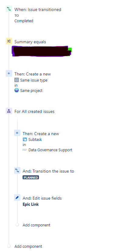

Hi,
I have set up a rule to auto recreate a task and sub task within the parent task, I would like the sub task status to transition to planned in line with the Parent task how do I do this please ? I am using Team Managed next gen.

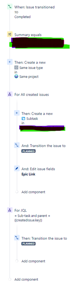

darren.johnson
September 17, 2021
Followed those steps and afraid it does not work, it falls over on the JQL step, is there another way of doing this without using the JQL step ?

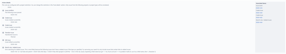

Darren, when you note it falls over on the JQL step, what do you observe happening and what do you see in the audit log?  Thanks!

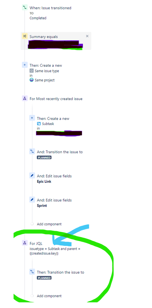

darren.johnson
September 20, 2021
Sorry but I am finding your instructions really hard to follow, are you able to take a screen shot of your example created please as I can't get it to work.
I don't know what the below means or how to create it, I am new to JIRA.
  • branch: on JQL with issuetype = Sub-task and parent = {{createdIssue.key}}
    • action: transition the sub-task to Planned
darren.johnson
September 20, 2021

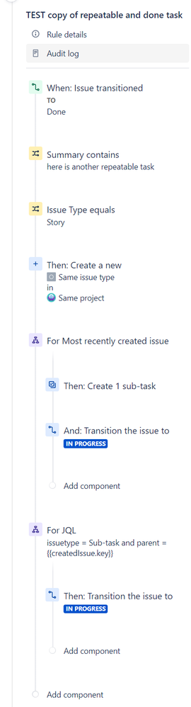

Bill Sheboy
September 20, 2021
Hi Darren,
It appears you have a typo in your JQL for the branch.  Here is an image of my test rule to do what you asked.
Kind regards,
Bill

darren.johnson
September 20, 2021
@Bill Sheboy Thank You however I still can't get it to work so just going to leave the sub tasks as new request status, when I enter the JQL it won't let me validate it, the validate button is greyed out, If I run it exactly as you have advised and it does not work the sub task stays as New Request so just going to leave this now I think. Thank You anyway unless you can expand the JQL branch showing me it has been validated and screen shot that for me.
