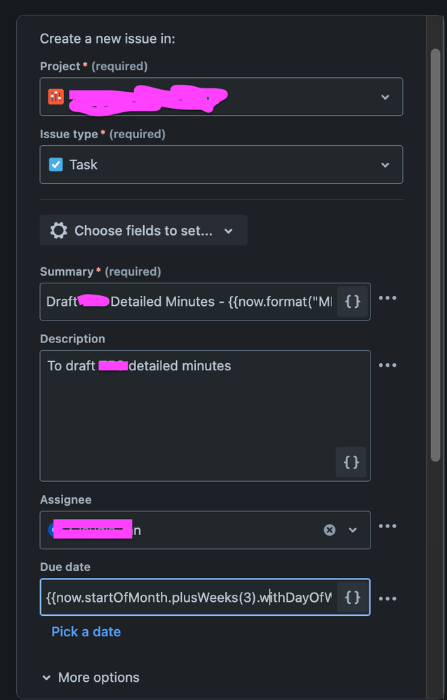

I have a Jira Software Team Managed project, which is essentially used for tracking the team's tasks. I have automation rules set up whereby recurring tasks will be created based on a specific occurrence. For example, I have set a rule whereby on every 3rd Thursday of the month, a task will be created - Confirm TEC attendance and a Slack message will be sent to the team. The due date for this task will be on every 4th Thursday of the month.
The task creation and Slack message is successful, it works. But the Due date field is empty. I have tried below smart values in the Due date field:
{{now.startOfMonth.plusDays(21).withDayOfWeek(4)}}
{{now.startOfMonth.plusWeeks(3).withDayOfWeek(4)}}
{{now.plusWeeks(3).format("yyyy-MM-dd")}}
{{now.plusWeeks(3).withDayOfWeek(4)}}
I have also tried removing the Due date field and use the additional fields instead using this (same smart values variations as above for Due date field smart values):

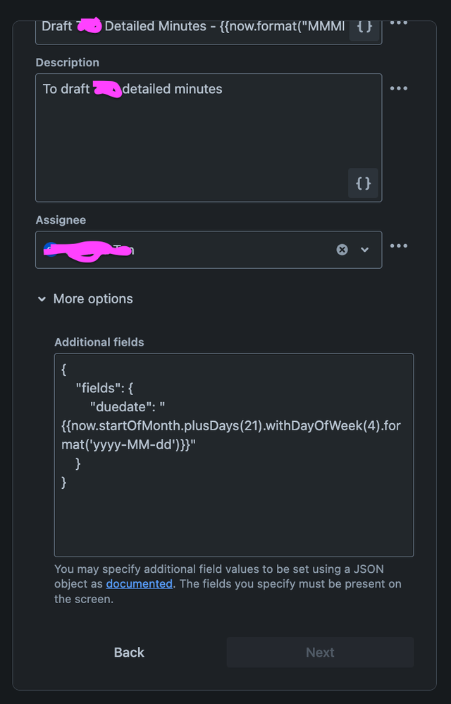

{ "fields": { "dueDate": "{{now.startOfMonth.plusDays(21).withDayOfWeek(4).format('yyyy-MM-dd')}}" } }
{{now.startOfMonth.nextThursday.plusWeeks(3).format('yyyy-MM-dd')}}" } }

Attached are the screenshots of my rule set up.
Screenshot 2025-02-13 at 12.09.06 PM.pngScreenshot 2025-02-13 at 12.12.09 PM.png

There looks to be a case issue. Can you try with fieldname as
duedate

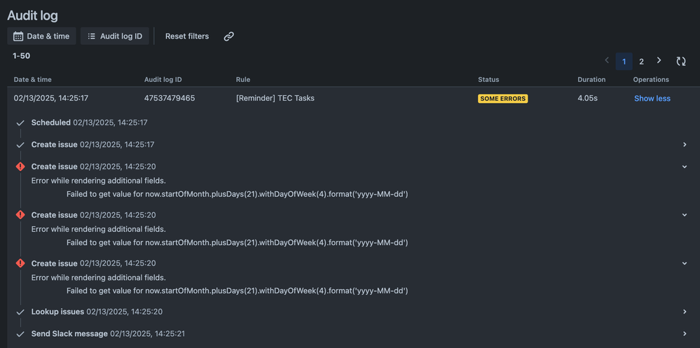

Also, if this does not work share the audit log to better understand the issue
Nur Fatin
February 12, 2025
Hello @Vishal Biyani thank you for the suggestion. I have changed from dueDate to duedate, but the issue persists.
Screenshot 2025-02-13 at 2.26.01 PM.pngScreenshot 2025-02-13 at 2.26.57 PM.png
Vishal Biyani
February 12, 2025
it is not working withdayOfWeek.
You can try with {{now.startOfMonth.plusWeeks(3)}}. this returns the date.

For future reference, please note the reason your JSON failed is including single rather than double-quotation marks.  When you want to use functions such as format() within a rule's JSON, add the asJsonString function at the end to add the surrounding double quotation marks.
For example:
"fields": {
"duedate": {{now.plusDays(7).format("yyyy-MM-dd").asJsonString}}
