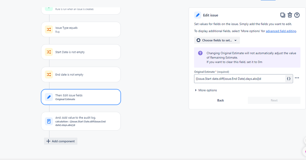

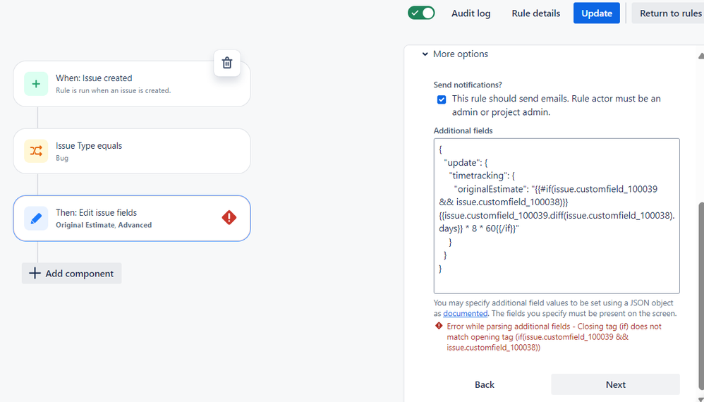

Hi Trudy,
Yes i have created automation rule. But its showing success but Original Estimate is not updating. Please find my Rule screenshot for reference.
Yes when ever Target start and end date gets changes i want Original Estimate to be changed automatically too and it should consider business days only like 5days a week.

The original estimate is not updating because your syntax is wrong.

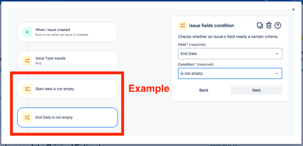

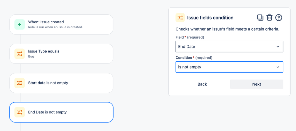

It appears that you are first trying to verify that both fields actually contain values. You can do that by adding Conditions to the rule rather than over-complicating the JSON code.
(I used Start date and End Date in my example. Replace those with the date fields you are using.)

Next, you don't need to use JSON at all. You can select the Original Estimate field and then set the value using a smart value.
The smart value you would use is:
{{issue.Start date.diff(issue.End Date).days.abs}}d
Again, substitute in the names (or customfield_##### designations) for the fields you actually use.
The .days.abs functions indicate you want the difference in days (vs. hours or any other time period) and you want the absolute value (not a negative value).
The d at the end is so that the number calculated will be submitted into the Original Estimate field as a value of days, just as if you manually entered 3d

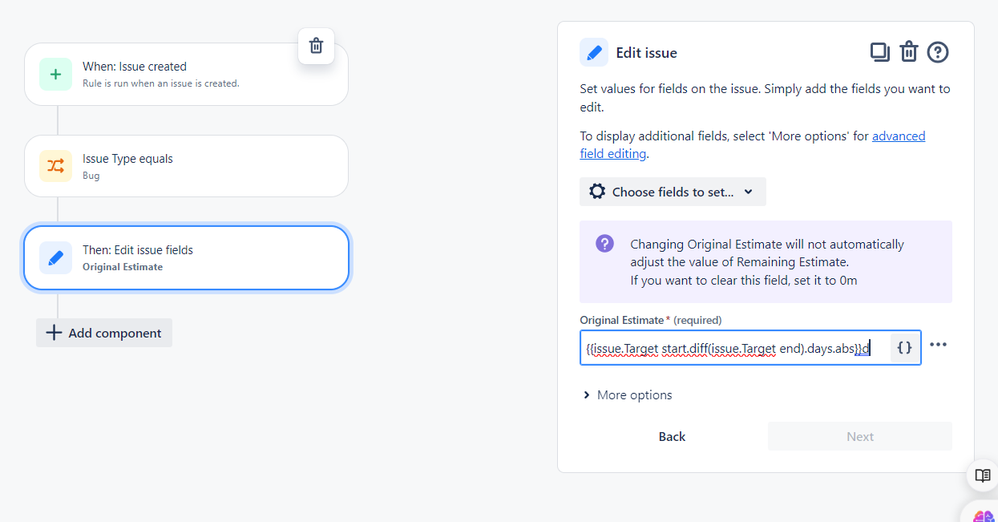

Hi Trudy,
Its not working as expected. I'm getting below error
TP-35 (Specify a valid value for Original estimate (timetracking_originalestimate), Specify a valid value for Original estimate (timetracking))

Hello @sai chinamuthevi
Please provide new screen images of your updated rule and the details of the Edit Issue step.

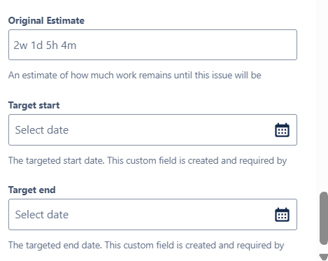

Hi
Please find rule and Fields attached.

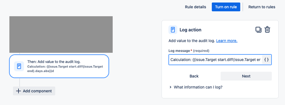

Trudy P Claspill
September 19, 2024
I have two suggestions:
1. Add a Log action to print out the value of the smart value you are trying to use.
That will add a message to the rule execution log showing the actual value the rule is trying to insert into the Original Estimate field.
2. Add the Conditions I previously recommended to ensure that the date fields actually contain values before you try to use them in a calculation.

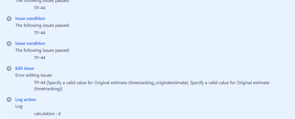

sai chinamuthevi
September 20, 2024
Thanks alot for your response.
Please find the updated rule and log for your reference :
Fields i used :
Start Date
End date
Trudy P Claspill
September 20, 2024
There are a few things that may be impacting the outcome of the rule.
1. Sometimes rules that use the Issue Created trigger are triggered before all the data is actually stored. Add a Re-fetch Issue Data  action after the trigger to ensure you are getting the full data for the issue.
2.Smart value field names are space and case sensitive. Make sure that the Field Names you use in the smart values match the actual field names in your issue.
3. Jira does not require unique field names. It is possible that there is more than one custom field named "Start Date" or "End date". You may need to use the unique Custom Field ID (i.e. customfield_12345) rather than the field name to ensure you are getting the correct data. For information about finding the custom field ID that matches the field you are using refer to: Find the Smart Value for a Field
sai chinamuthevi
September 23, 2024
Hi,
I used Id's instead of names and yes its working now. i have added refetch issue data too. Thanks alot for the support. :)
