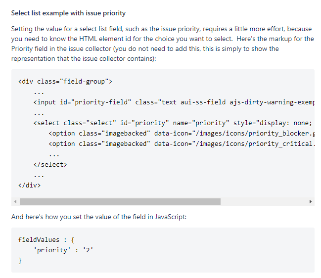

Yes, I worked through the documentation and was still getting stuck. It appears that as long as I have the HTML value for the list field, I should be able to assign the field value as per the javascript above (note: experimented with using '3' and '11919'). Description and component are populating as expected but the Severity is still always set to "None" when the Issue Collector is opened.
Documentation referencing:
Severity values:

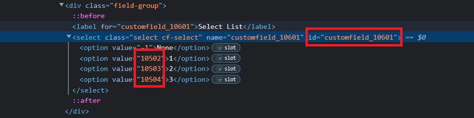

Hi @Julia Lang
I'm not sure but from my understanding you should use something like that
fieldValues : {
'customfield_XXXXX' : '11917'
Where XXXXX is the customfield id for Severity
Then the value is the option id of the option in the list.
In the example from the doc they use priority that is the name of the field but also the id of the field as it's a system field, for customfield id is different from the name and is customfield_XXXX.
Regards
