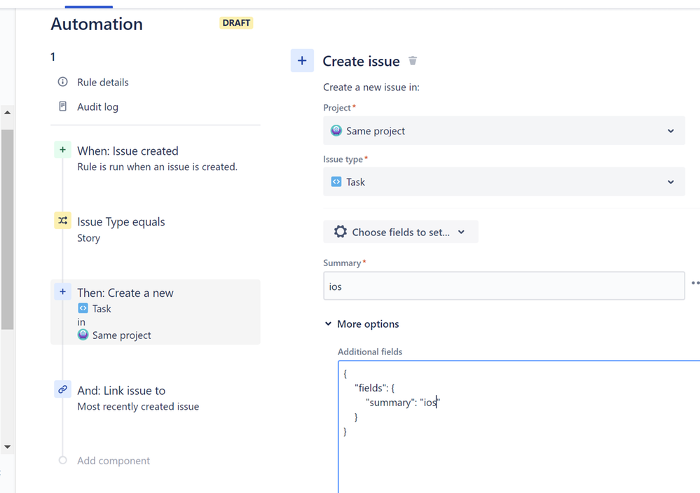

Hi there,
I want to automatically create 3 tasks when create the story.
for example
>create story "change the login flow"
>automatically create tasks of
  1. "iOS-change the login flow"
  2. "Android-change the login flow"
  3. "server-change the login flow"
and these tasks will related to the story.
I use the automation function but I don't know how to write the json of it, because I cannot figure out the smart value of the parent story. this is my current automation setting.

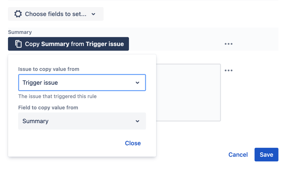

Walter Buggenhout
December 27, 2022
Hi @Jessie Li,
Most likely, there is no json required to set field values. You can copy values from the trigger issue just like this:
Screenshot 2022-12-27 at 16.40.46.pngJust select the fields you want to fill out. With the ... link next to each field select copy from and then update the selected option to copy ... from trigger issue as you can see in the above screenshot.
Hope this helps!
Jessie Li
December 28, 2022
Thanks Walter, it's solved. 😊
Ravi Sagar _Sparxsys_
December 27, 2022
Hi @Jessie Li
You need to use JSON for setting fields not supported yet by the automation. In your rule you are already setting Summary to "ios". You can also set other fields like this.
Ravi
Jessie Li
December 28, 2022
Thanks Ravi, it's solved. 😊
