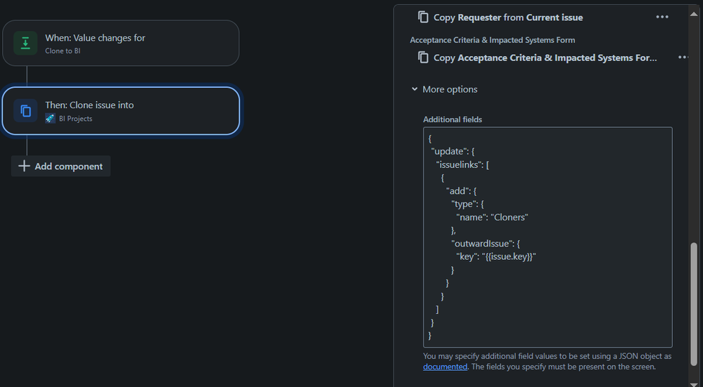

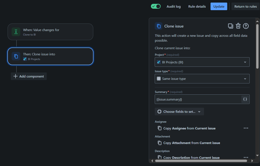

Hi everyone,

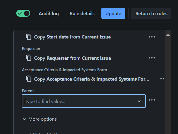

I created an automation rule to auto-clone issues from projects A, B, and C into project BI and link them using the 'Clones' issue type link. Now, the problem is it also auto-clones the parent, which is a problem. What step should I add to the rule to stop it from auto-cloning the parent? The thing is, I have not added the 'Parent' field to copy from the current issue, but it still does.

For the first one (clone the Parent field), that field cannot be cleared by selecting it and leaving it empty in the rule action.  Instead it may be cleared using advanced edit with JSON, by removing the Parent field from the dropdown selections and then expanding the "More options" section:
"fields": {
"parent": null
Kind regards,
Bill
BenWade
June 3, 2024
Thank you very much, @Bill Sheboy
I have just incorporated the provided json to mine and done 👍
"fields": {
"parent": null
