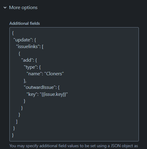

Here is the code used to link cloned issues. I believe I simply need to modify the code below to use the "relates to" link type instead of "Cloners". However, I'm unsure if this is correct and how to properly modify the code. Can someone help me with this?
If only the code below needs to be modified, please provide adjusted code for my case. Thank you!
"update": {
"issuelinks": [
"add": {
"type": {
"name": "Cloners"
"outwardIssue": {
"key": "{{issue.key}}"

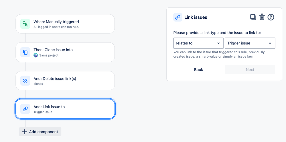

Is there a reason why you do not want to handle it link below? Basically to remove the clone link and relink with a different type with additional blocks?

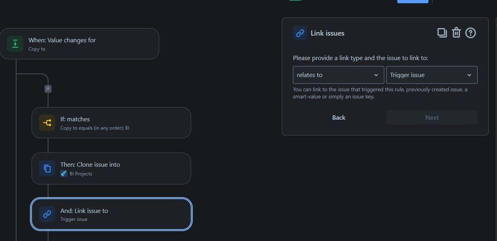

May 8, 2024
So this is the flow but it does not link the issues. What can be the problem?

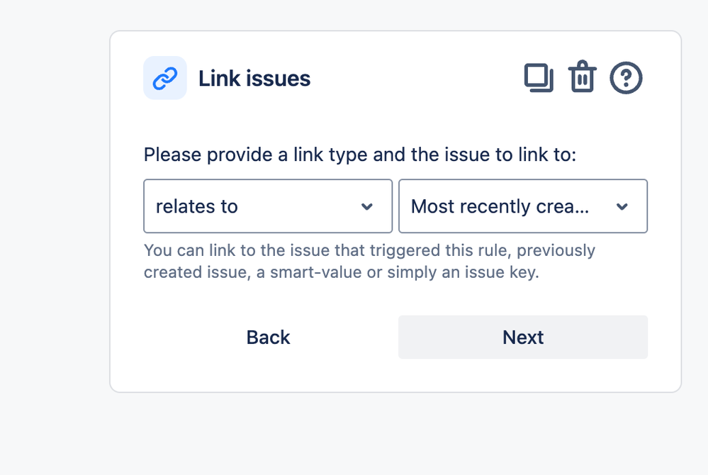

Fazila Ashraf
May 8, 2024
ah my bad. Please use the below setting
Like • BenWade likes this

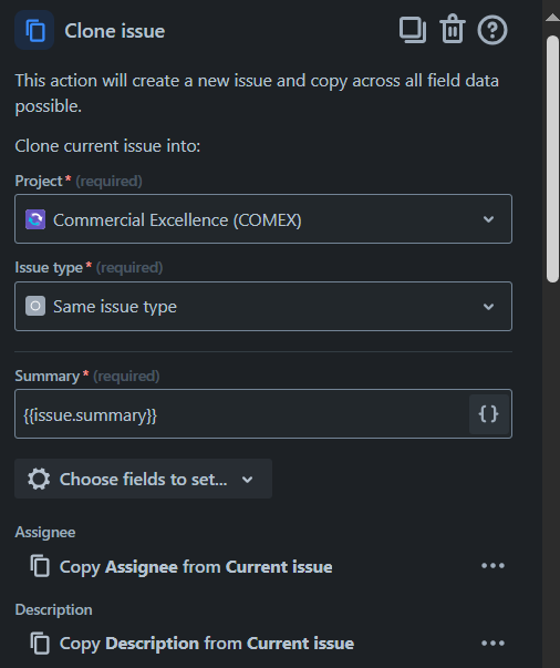

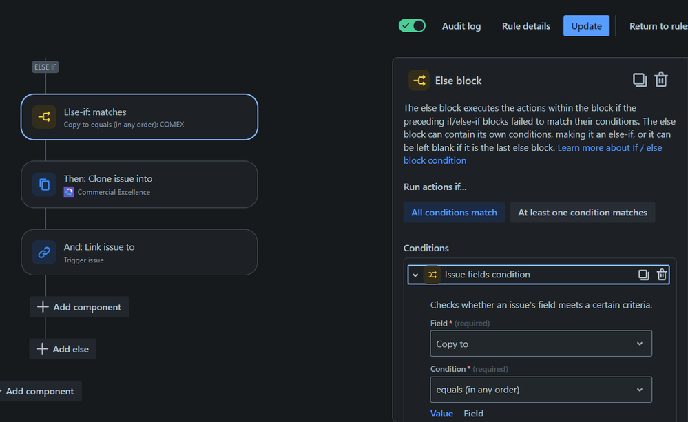

I will chnage it now. But why 'trigger issue' does not work? It should work, no? Because the ticket in Porject A triggers the automation when I add value to 'Copy to' field
Fazila Ashraf
May 8, 2024
What is the 'Copy to' custom field type? Are you sure for the not triggered issues, the value equals to COMEX?
