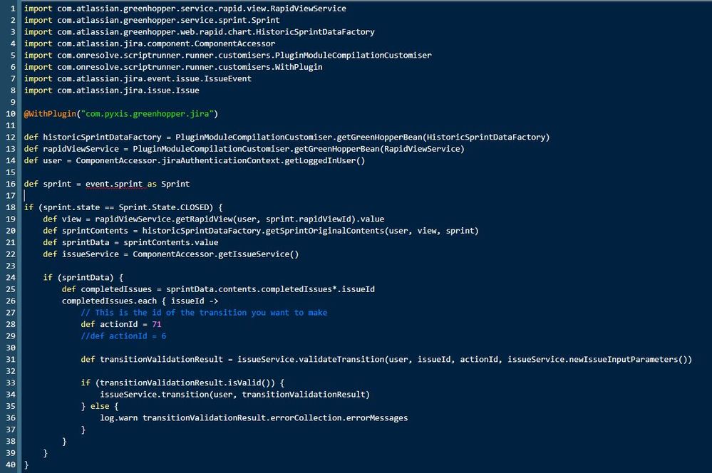

I have found a solution to my script. Here is the code:

I have looked at the community answers and found a couple of different scripts and events. I tried to merge them and create a custom listener to move issues from done to close status when sprint is closed.
The script is running into some errors. Here are the logs:
The following log information was produced by this execution. Use statements like:log.info("...") to record logging information.
2019-04-05 19:04:31,708 ERROR [runner.AbstractScriptListener]: *************************************************************************************
2019-04-05 19:04:31,710 ERROR [runner.AbstractScriptListener]: Script function failed on event: com.atlassian.greenhopper.api.events.sprint.SprintClosedEvent, file: <inline script>
org.codehaus.groovy.control.MultipleCompilationErrorsException: startup failed:
Script89.groovy: 29: unable to resolve class IssueInputParametersImpl
 @ line 29, column 95.
   rrentUser, issue.id, actionId,new IssueI
1 error
Can you let me know from the logs if there is anything that I am missing or I need to change anything?

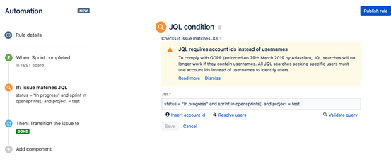

I understand that you are trying to automatically transition all the issues in the done status to Closed when you complete the Sprint they belong to. Is that correct?
I'm not sure why this error is happening for you on Scriptrunner, however, I would like to suggest you a different plugin to easily achieve this goal: Automation for JIRA
Since the Automation rule would only be triggered when you close a Sprint, I believe you will not consume more than the 300 free executions per month, so you will not have any costs on it.
This would be the rule:
P.S: In the example above, I used the statuses "In progress" and "Done" since they were the ones available in my test instance.
Let me know if this option helps.
