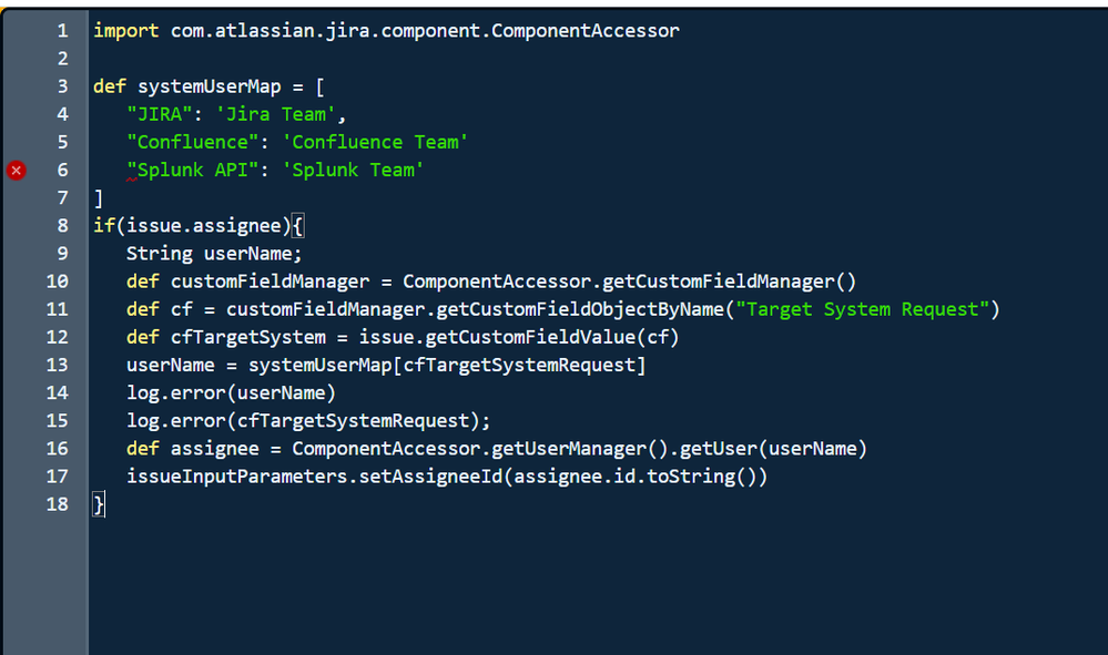

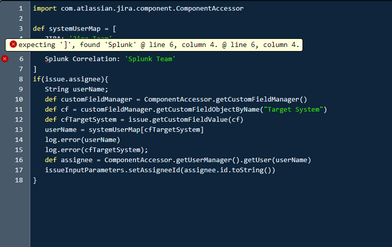

John_Diaz
March 16, 2020
Hi @PD Sheehan first, thank you for responding to my post.  I tried adding your script and added an addition condition that if Splunk Correlation is selected then assign to Splunk Team and get an error.  Do you know what I'm doing wrong?

If you have spaces in the system name line "Splunk Correlation", you must put quotes around it.
John_Diaz
March 16, 2020
@PD Sheehan It removed the error but unfortunately, it didn't work.  It still assigned to the project lead.

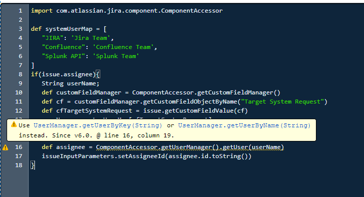

John_Diaz
March 19, 2020
@PD Sheehan This is what I see now.  Sorry, I'm a beginner at this.Target System Request.PNG

PD Sheehan
March 19, 2020
Ah... yes... that error (just a warning really) was in your original script and I didn't validate it since I was focused on "how to add another condition"
This is letting you know that the getUser() method is no longer recommended and will disappear at some point. So might as well fix it now.
def assignee = ComponentAccessor.userManager.getUserByName(userName)
 This assumes that the actual username (the one that would be used for logging in to jira) are what you've specified in the sysmteUserMap ('Jira Team', 'Confluence Team' etc) .
If "Jira Team" is the display name for a user with a username like "jira_team_user" then the map needs to have those explicit usernames

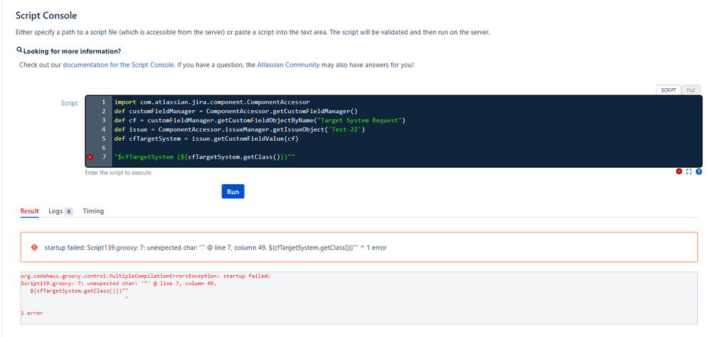

Can you please try this in the console (replace the ticket number with a valid ticket that has a value in the custom field
import com.atlassian.jira.component.ComponentAccessor
def customFieldManager = ComponentAccessor.getCustomFieldManager()
def cf = customFieldManager.getCustomFieldObjectByName("Target System Request")
def issue = ComponentAccessor.issueManager.getIssueObject('JSP-1922')
def cfTargetSystem = issue.getCustomFieldValue(cf)
"$cfTargetSystem (${cfTargetSystem.getClass()})""
 And let me know what the output is?
John_Diaz
March 19, 2020
John_Diaz
March 19, 2020

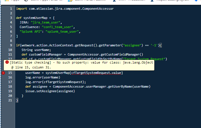

@PD Sheehan Good news, everything works.  If I assign the ticket to myself and hit create it's still assigned to me.  If I leave it unassigned and hit create, it will automatically assign to the right team per my script (with your help of course). Weird thing is...everything works fine but I see this error.  Thoughts? Target System Request.PNG
PD Sheehan
March 19, 2020
We're getting there....
Try the console code again but remove the extra double-quote we can make sure if .value is needed at the end of cfTragetSystemRequest.
But since it appears to work, that error can likely be ignored. These sorts of static type checking errors are not always indicative that something needs to change. They are there to help you identify POSSIBLE issues with the script.
In this case, the code editors can't know what type of object cfTargetSystemRequest is. It could be a string, or it could be some other class. So it doesn't know if .value is a valid property/method.

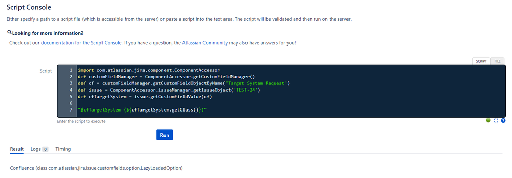

John_Diaz
March 20, 2020
This is what I get with Script Console.

Hi @John_Diaz
Looking at the console output, I see that the custom field contains "LazyLoadedOptions" object which is the same type of data that is stored in a build-in single select field. So since cfTargetSystem will be such an object, to get the actual text of the option, you would use cfTargetSystem.getValue() or cfTargetSystem.value for short (which is what I suggested in the last instance of the script).
