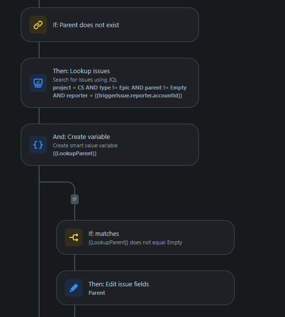

Hi all,
I am trying to create an automation rule that automatically links the newly created ticket to an epic for a new JSM project. In this project, each epic will represent a different customer project that my team is working on. My current rule is below. I am trying to use the reporter account ID to match the new issue to another that the user has made before and then copy that parent link to the new ticket. Do you guys have suggestions to make this method work or another method that would work better?
Other factors that may be relevant or could be used:
- I have a form for the customer to fill in that has a field for them to put the project name in which would be a similar name to the Epic name
- I can't put a parent field for the customer to fill out as that would allow them to see other customer projects.

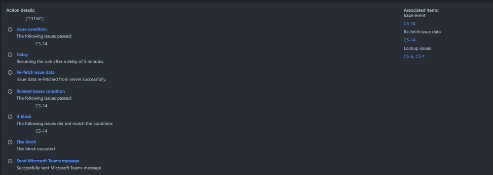

I am looking for issues created by the same person in the same "CS" project. The lookup issues is working as expected. The main part I am struggling with is being able to take the same parent and link it to the newly created ticket.
Lower in the rule, I have an else block which is performing as it should. But the audit log is stating that the newly created ticket does not match the first if statement which is supposed to do the automatic linking.

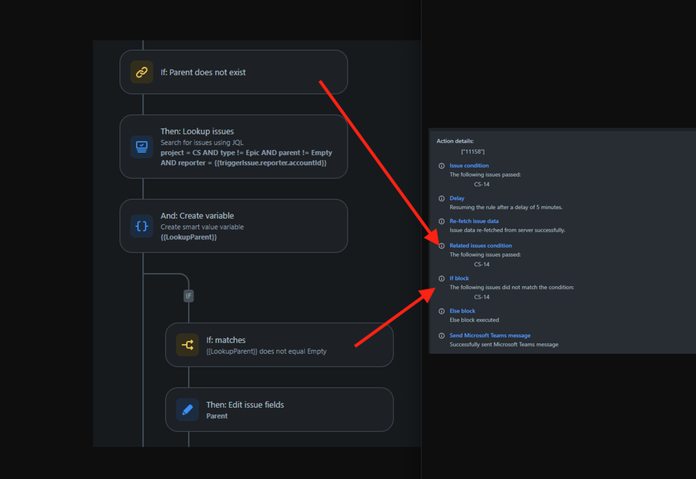

It appears that these steps align with these messages. Do you concur?

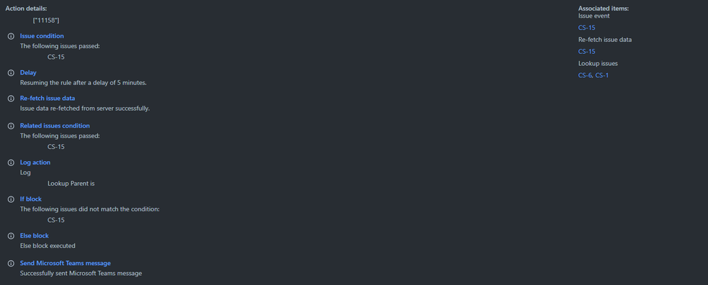

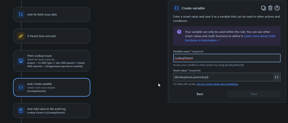

Here are the details as requested. Thanks for the help! In doing the log action, I found out that the {{LookupParent}} is not populating which is a good step!
Audit Log:
2024-11-25 09_37_44-Audit log - Automation - Customer Engineering Service - Jira.png
Variable Details:
2024-11-25 09_38_20-Audit log - Automation - Customer Engineering Service - Jira.png

Your variable may not be getting set correctly because either your Lookup Issues action is not finding any issue, or because the smart value you are using in the Create Variable action is wrong, or both. In this case I can confirm that the smart value you are using in the Create Variable action is wrong.

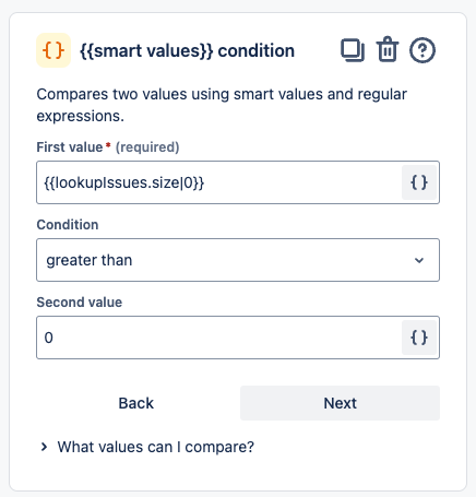

I do recommend that you add a Ccondition after the Lookup Issues action to confirm that at least one issue is found. You can do that thusly:
That will confirm that there is at least one issue returned by the Lookup Issues action.

To get the parent epic for an issue in the Lookup Issues list you need to use a smart value that will look at a specific issue in the list. You could use:
{{lookupIssues.first.parent}}
...to get the value in the Parent field for the first issue returned in the Lookup Issues list.

Did you notice the Create Variable action was using an incorrect smart value for the lookup issues result?  It was singular and not the plural {{lookupIssues}}

Thank you @Trudy P Claspill and @Bill Sheboy !! I was able to fix the automation by fixing the smartvalues and adding in some extra checks. Really appreciate the help!
