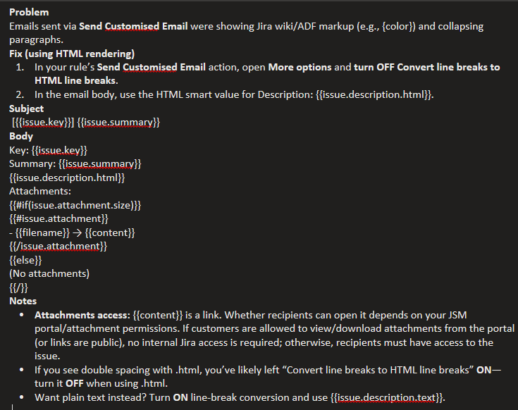

The goal was to auto forward a received email with attachments that met certain criteria (if and or) to another email address. The issue was that there is no way to forward the actual email at a Jira level. This can be set up at an exchange level but was more complicated. I have found though that using the Send Customised Email function within the automation rule with the following Json code gave me the ability to forward the email with the attachment as a link.
Another issue I wan into was the email format was not in HTML so it did not display correctly. Adding on .html to the code solved this issue. Please see my notes for a work around:
Another issue I ran into was the email format was not in HTML so it did not display correctly. Adding on .html to the code solved this issue. Please see my notes for a work around:
